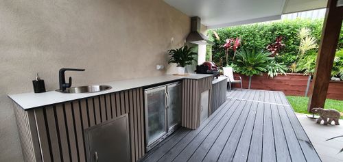

I built my own outdoor kitchen a few months ago and had the same issue with the benchtops and prices of being quoted for granite and outdoor ceaserstone.
I ended up going with 1200x1200 porcelain floor tiles that were then cut to size.  As the longest part of my bench was 1700 long there is only one join on the total bench.
Here is what it looks like when the tiles were laid down and then finished with appliancesBBQ 3.jpgbbq1.jpgBBQ2.jpg

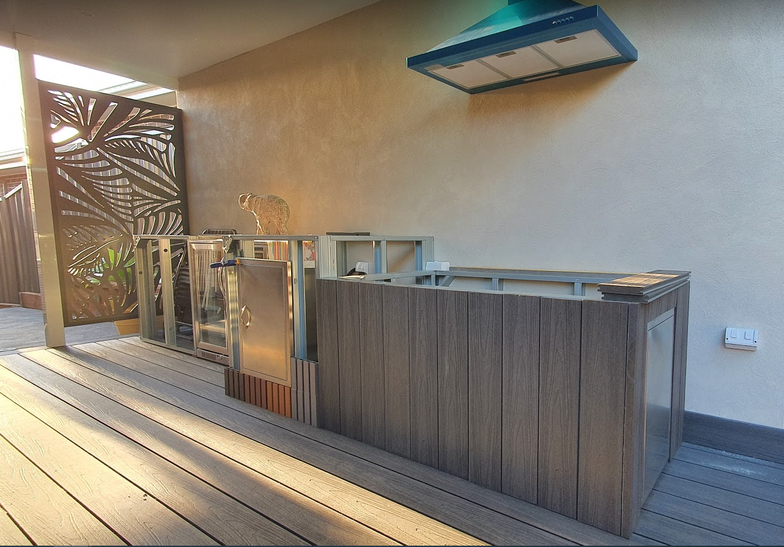

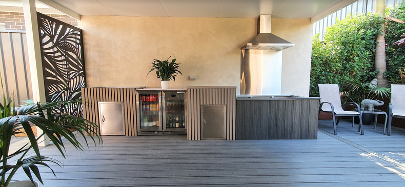

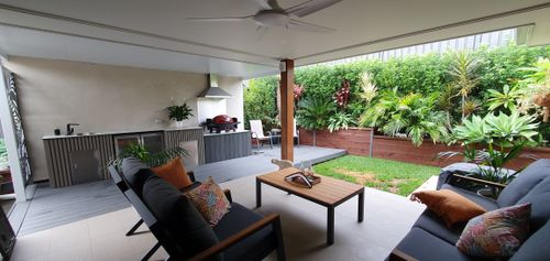

6 weeks on and a little more work has been done. I used left over ekodeck offcuts and cladded the bbq section of the kitchen. The rest of the kitchen will be cladded in a composite slat (samples are shown to work out the best colour). Were going with the light grey to keep the base palette neutral.
I purchased stainless steel doors from ebay, connected power and installed the Bellini Rangehood (another Bunnings product). I may have to upgrade to a commercial unit, but the cost for the Bellini was quite cheap so we'll see how it performs in the short term. Consideration was given to the height of the rangehood over a gas cooktop and it is installed within those limits.
The rest of the BBQ is now cladded, and all stainless steel doors installed. The stainless steel splashback for the BBQ section is installed also. Power is hooked up and I eagerly await the arrival of my benchtops tomorrow so I can complete the sink, tapware and hook up water and drainage and install the pelmet to cover the gaps between the ceiling and the blueboard. We're almost there!

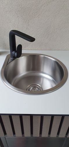

The benchtops finally arrived and so I've been able to install the sink and mixer tap and connect them to water and drainage. The ziggy is in its final resting place and a couple of BBQ's have been had to christen the kitchen. Just have to secure the sink,  benchtops, add the vertical infill piece next to the BBQ and add the LED lighting feature. We are pleased with the results and the benchtops have really brought it all together.
Just waiting now for the pizza oven to arrive and to add some finishing touches and that will be a wrap.
