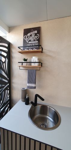

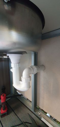

Just a quick update to show what I did to connect my 20mm poly pipe to the mixer tap. I purchased a 20mm to 1/2" pex smartex connector. Just slip it on and voila! As I'm only running cold water, I needed a Y fitting for the 2 mixer hoses so used a brass Kinetic fitting. Plumbing tape between the pex and kinetic fittings was required to guarantee a good seal and this system worked like a charm with no evident leaks. Great to have water available now.
So to drain it away, I purchased a P trap and drilled a 50mm hole in the blue board. With a little bit of reaming, I was able to get a 50mm pvc pipe out behind the board and connected to drainage lines.
Here a the final results of this work.

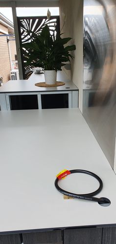

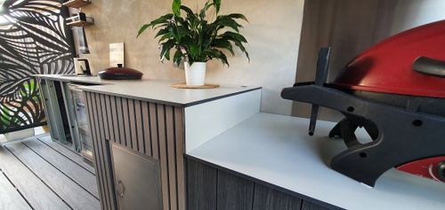

Now to add the infill panel to the step down in the bench top. The material is dense and difficult to cut. It's also easy to chip the surface material so I used my speed square and spirit level to guide the saw along the cut line minimising any burring of the finished surface. Slotted the panel in for a pretty good fit and the benchtops can now be secured to the steel frames and the gaps silicones. That's this weekend's job.

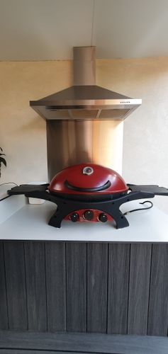

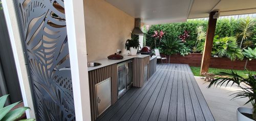

Done.
