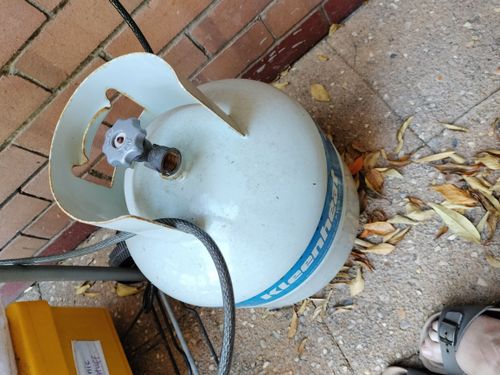

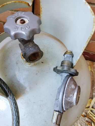

My bbq is leaking gas from the connector.
I disconnected it a few months ago to move house and decided I'd have a bbq tonight.
But I can't get a good seal now it's leaking.
Nothing about the connector components had changed.
Can anyone help? Thanks

Does anyone have any thoughts about trying the connector with an O-ring or a gasket sealant?
I've removed the plumber's tape and it still leaks.
The bottle connector is nice and clean with no obvious corrosion or damage.
Thanks

I'd advise that you discontinue use of your BBQ immediately, as leaking gas poses a significant risk to your safety.
It looks like there is an O-ring missing from the tip of your gas hose, which is the likely cause of the leak. Unfortunately, regulations for gas bottles and BBQ gas hoses changed in 2021, and this style of gas hose, which uses a Type 21 POL fitting, is no longer being sold or supplied with BBQs as they are currently in a 10-year phase-out period.
This means you are going to have to replace the hose with a new gas hose that uses a Type 27 LCC27 fitting, and replace the gas bottle with a compatible bottle.
Unfortunately, as the regulations have changed, this is your only option. I'd suggest you contact the manufacturer of your BBQ, as they will be able to offer guidance on what kind of LCC27 gas hose is compatible with your BBQ.
