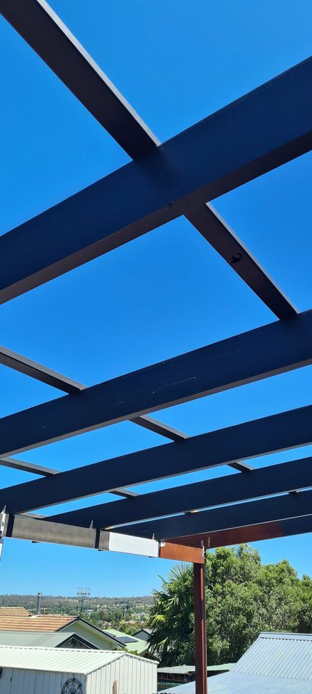

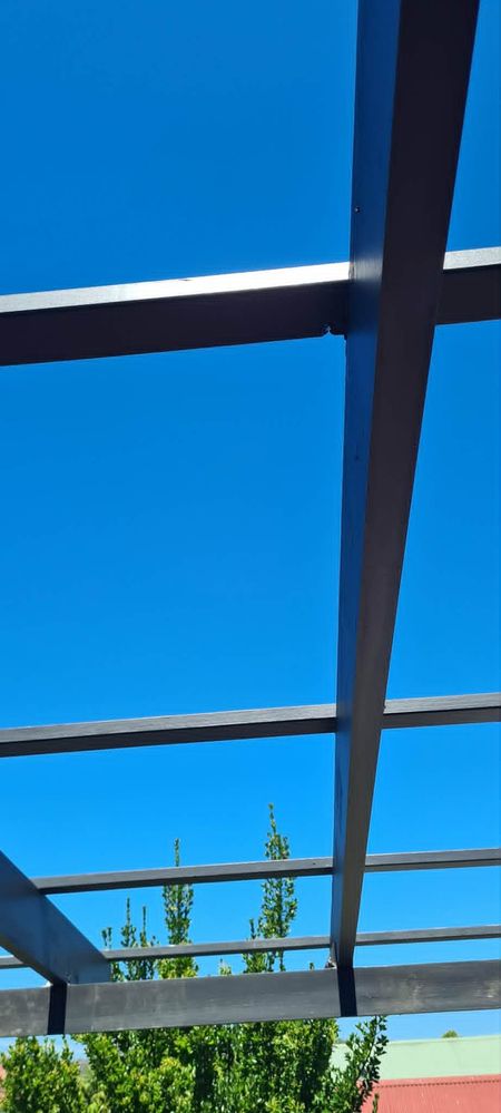

with the laserlite-this has been removed
awaiting the new colourbond
new batons
Hi Jacob, thanks for the advice. I have attached pictures with and now without the laserlite. The new roof is colourbond. I did see that advice on the thermal blanket hence my questions. Thanks.
