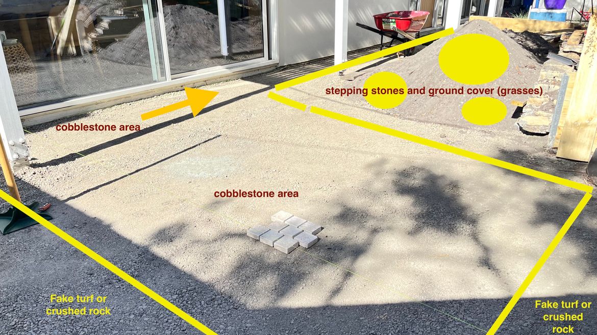

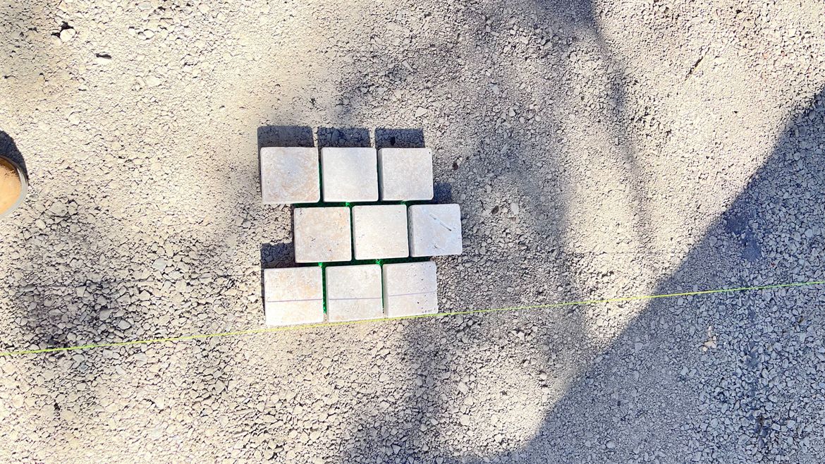

@JacobZ - another query. With the mesh cobblestone work, it is likely to take a number of days to wet lay (with the mortar) on the compacted road base. We will wait to grout once all completed. Will it be a problem if we get some rain during this time? or would it be best to cover with builders plastic if raining? It is hard to find a full 3-4 day period I have in a row available that does not includes some form of showers here in Melbourne!
Also, we have a gap to the edge of some of the cobblestones (on mesh). It won't quite fit another cobblestone and I know I may have to cut them, which I am trying to not to have to do if there is any other options. The outer edge of the cobblestones will also need some sort of edge/support. What could be done here. Mortar? or other to edge them in. We are planning to either have crushed earth with some grasses (poa grass etc) and some stepping stones or even fake turf to give it some colour. *apologies, as this could be a seperate post but thought I may as well continue from my last question.
