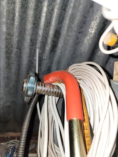

It was a very, very long time ago @jjgarth and they're well and truly packed away now - but once upon a time you could buy barbells with the perfect length and the perfect grip that had the coarse thread for the collars.
Are they still available?
