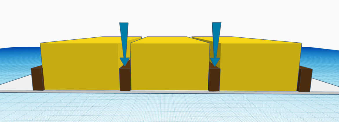

Hopefully, they should extend outwards above the batts as per the image below and meet each other. However, if they don't meet each other and there are gaps similar to the second image, then those need to be addressed, as cold/hot air can bypass half the thickness of your batt and reach the timber. Those gaps would really affect the R-value and diminish the point of going for the thicker batt in the first place.
No need for H3 or H4 timber inside; that's just for exterior use, where it will be continuously exposed to the weather.
