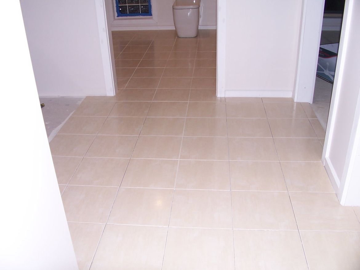

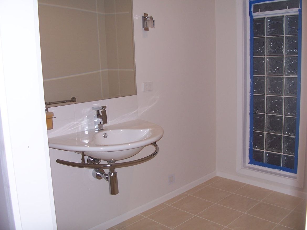

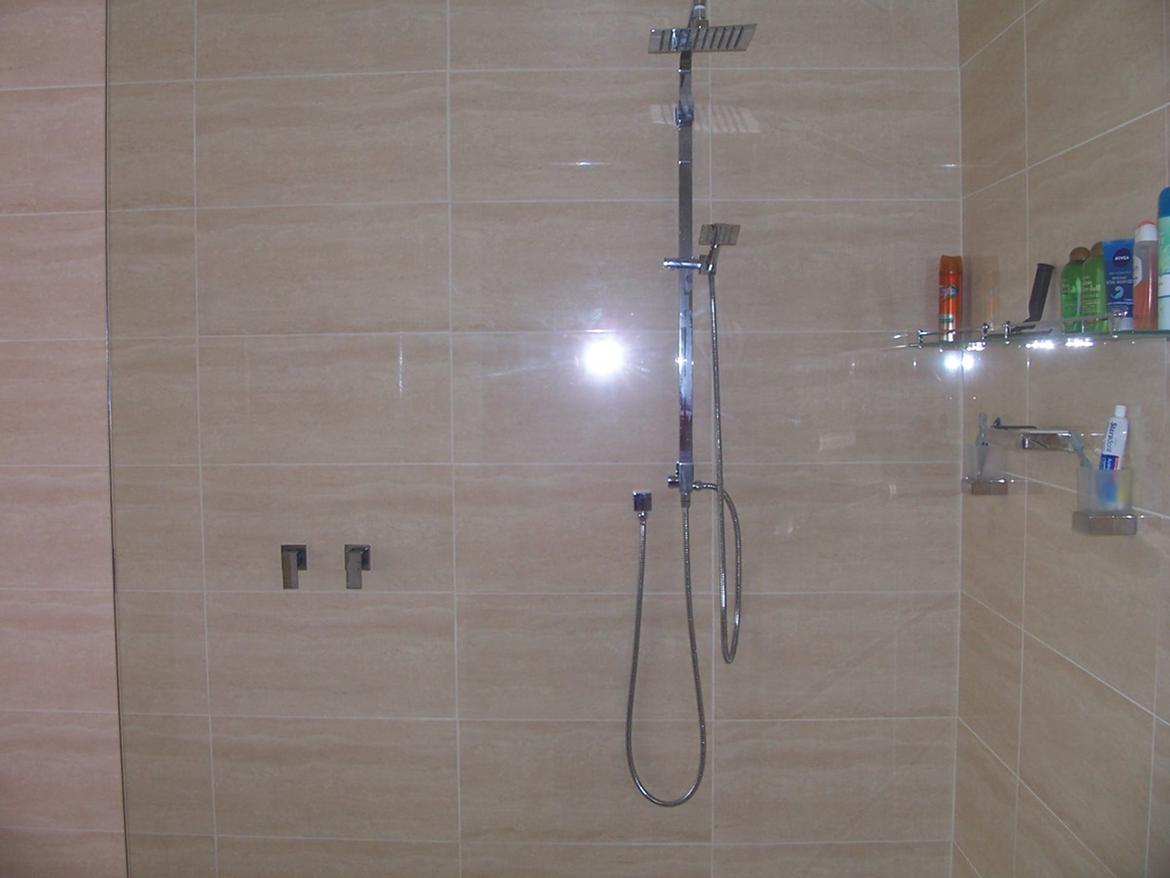

Main bathrooms is complete including tv cable now too although shown incomplete in the photo
Ensuite complete

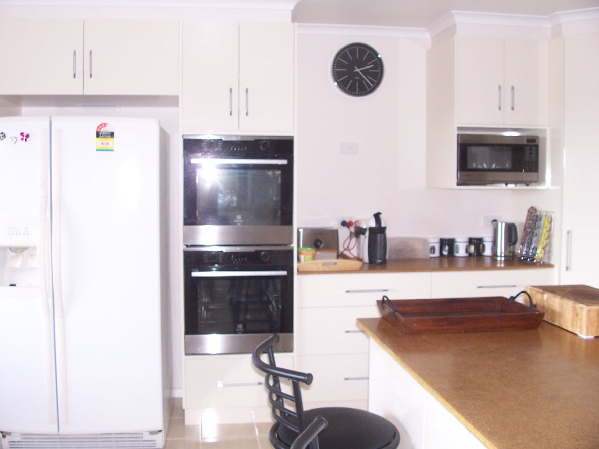

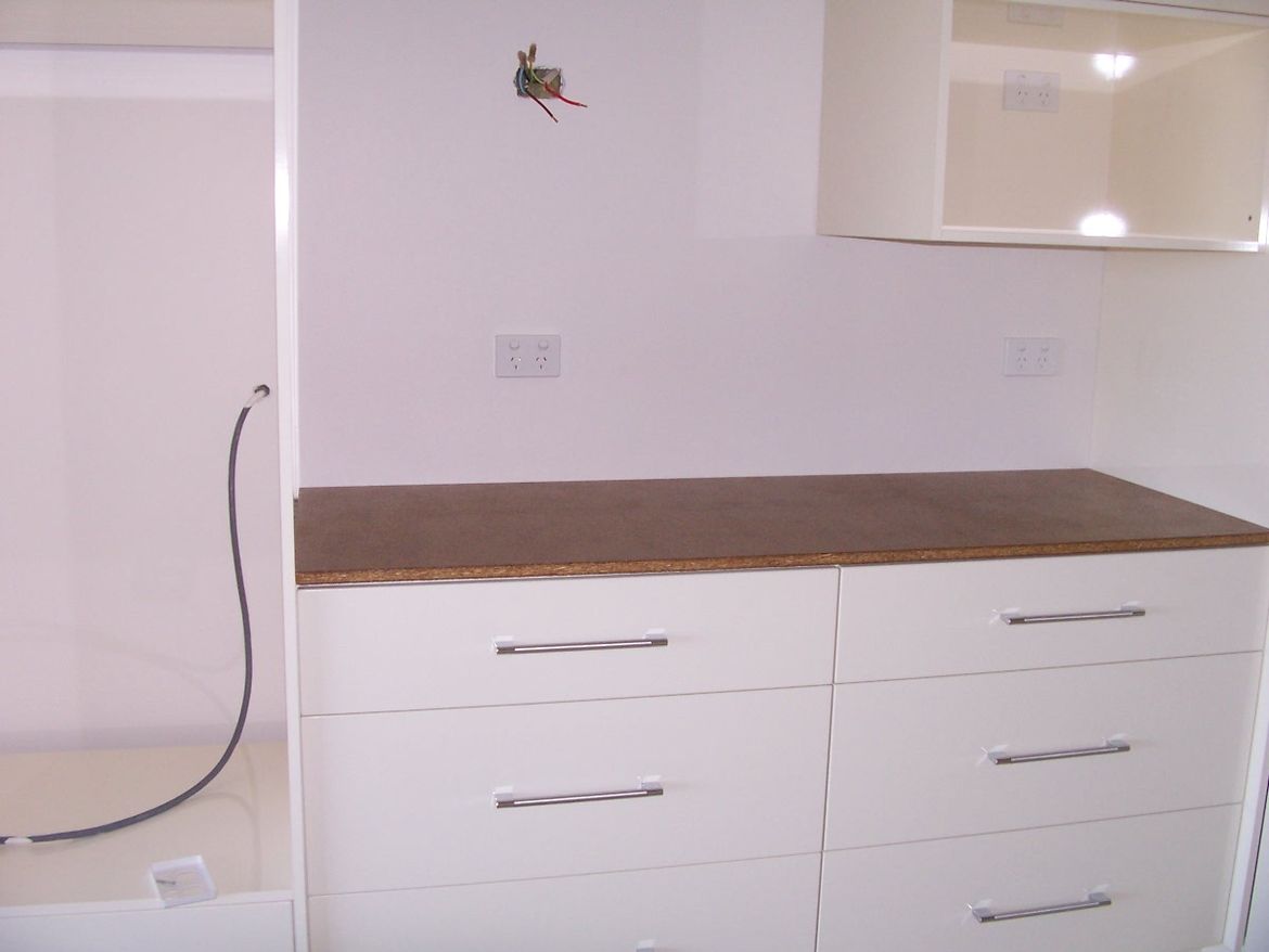

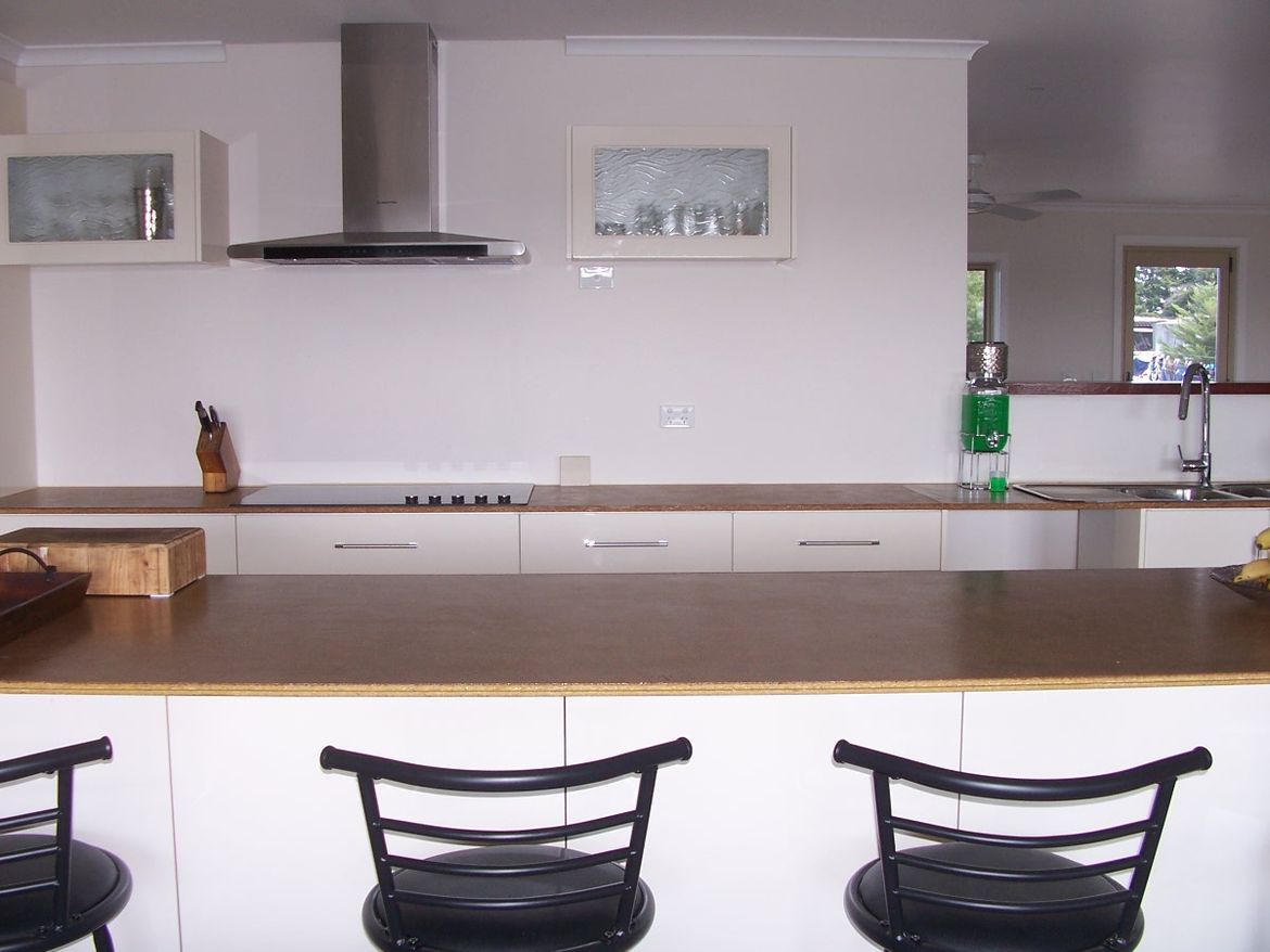

Kitchen has just gone in, bench tops will wait till next year but have used varnished green tongue flooring for now. Ovens are in situ and just need connecting and hotplates should be ready to pick up tomorrow!! Some safety switches to do once the ovens and hot plates are connected as well as finishing the cornice and painting the bulkheads

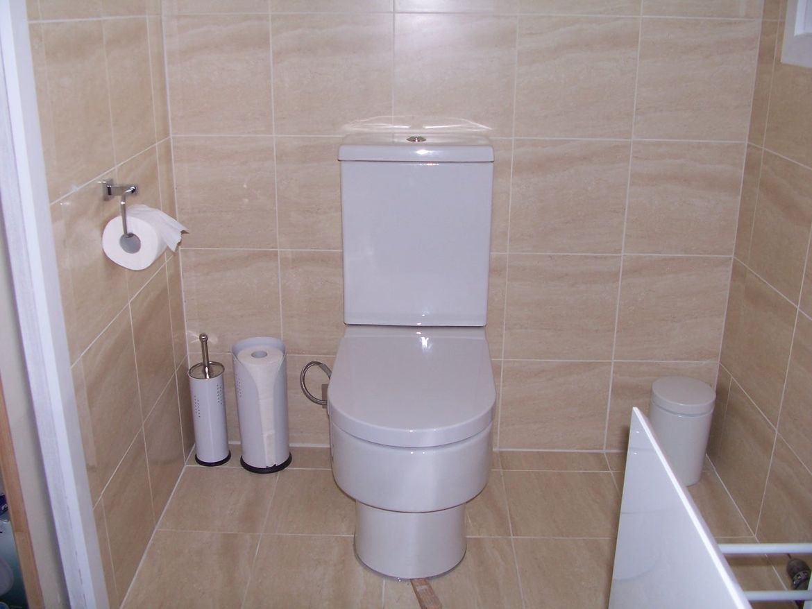

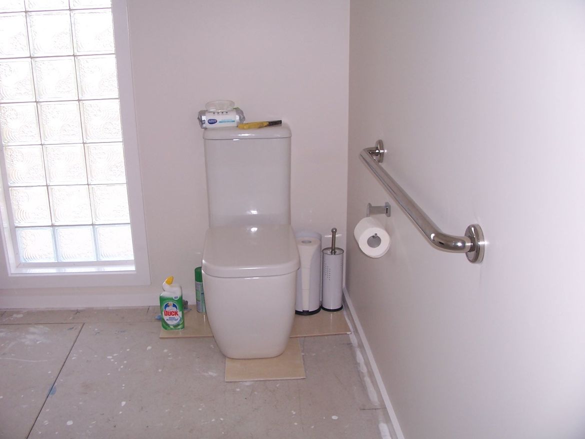

Main toilet complete including tiles but first photo was taken before that, second photo shows tiles done.

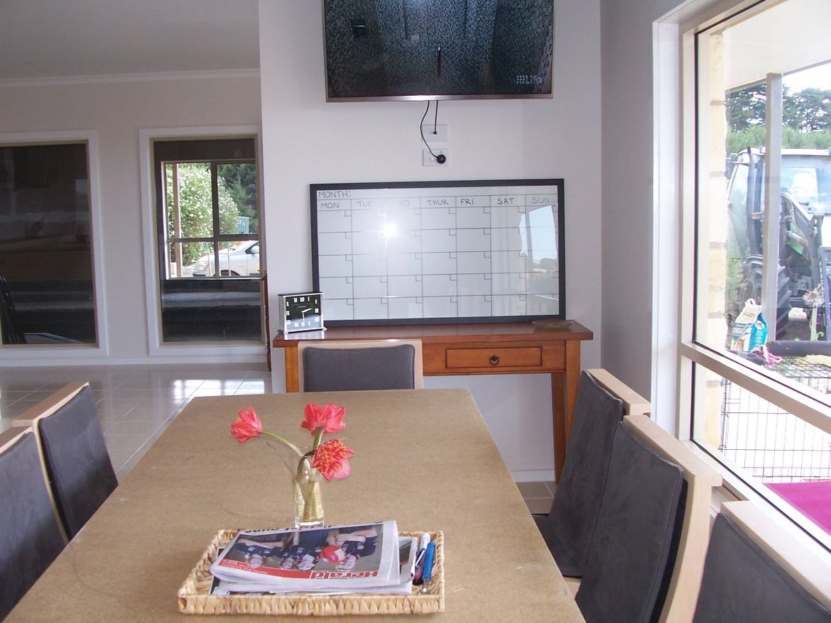

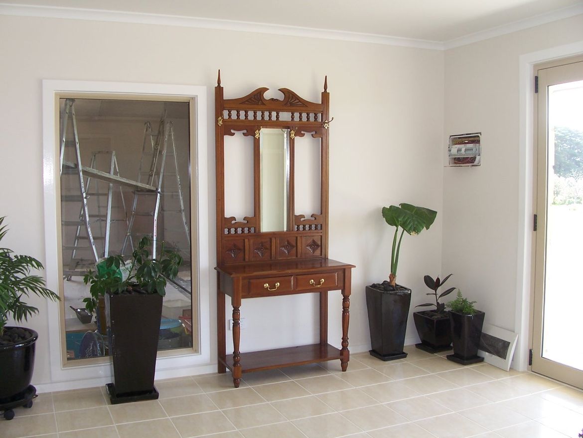

Photo's of a few other areas in the home including entry with hall stand and dining area with buffet. Plants next to the hall stand are meant to be in the pool room but dust from sanding was suffocating the plants, so I moved them into a better environment until they can return to their spot. If you look through the window beside the hall stand, one can see the ladders that we were using to stop and sand the pool roof but we have decided to delay any further works in lieu of filling the pool and making the most of it over summer. Will attach pool photo's in a few days, currently filling it with precious drinking water from our storage tanks, the sacrifices that we're making ha-ha!!

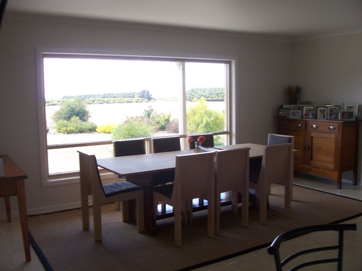

Kitchen is usable with polyurethane flooring as makeshift benches for now, soon to be covered with stainless with cook top and sink splash back also in stainless. Stone bench tops to come in a few years at a further $7000 cost right now, probably $10,000 by the time we can afford it, so the stainless will see us through till then!!

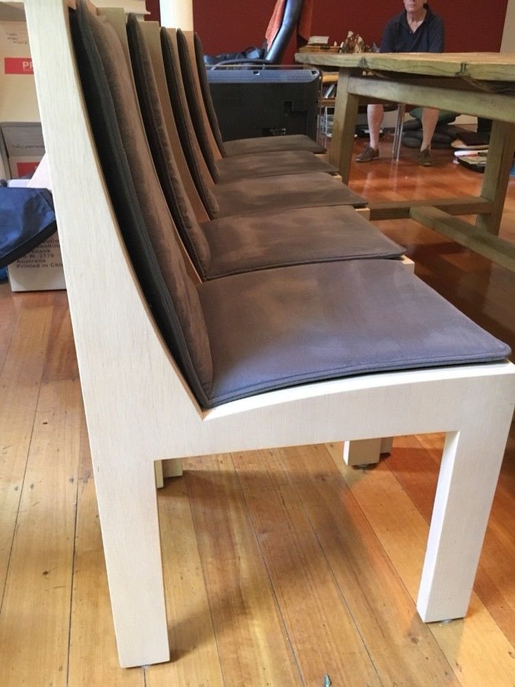

Dining table is solid red gum, although not visible but we had a failure with the first attempt of using liquid glass, too hot a day we think and we just couldn't stop the air bubbles reappearing even after two hours of popping with the blow torch, so the top has gone outside again for a slight re sand and we'll have another go when it's cooler but again, the trusty flooring is our table top for now. Chairs were bought on Ebay for $23 each, fantastic buy, unusual style but cut from a single piece of timber so very strong. They will be painted black eventually but as we plan to use a spray gun, we will wait for cooler temps.

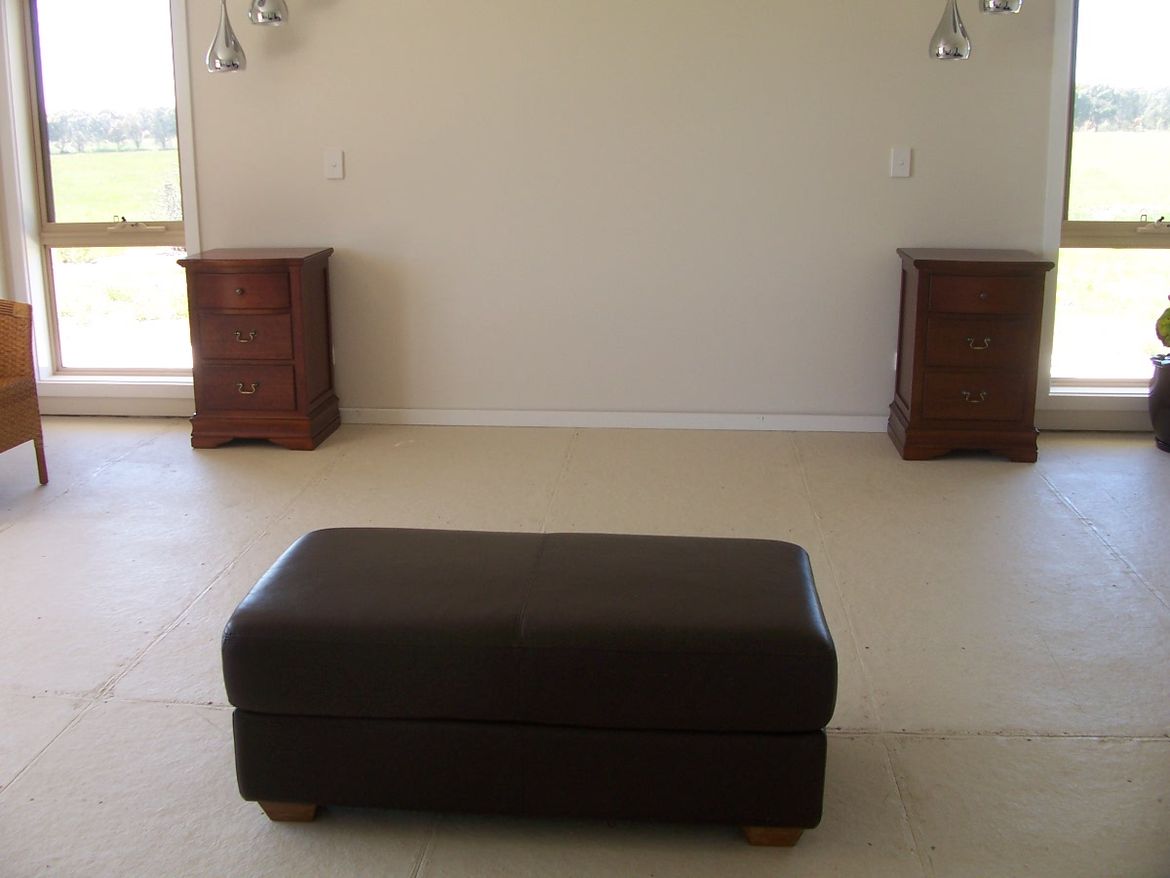

Next photo is the master complete with carpet and sorry just noticed the two firearms still on the ottoman, hubby was attempting to clear the garden of blackbirds ha-ha the three pics show east, north east and south east views.

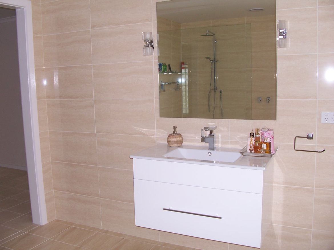

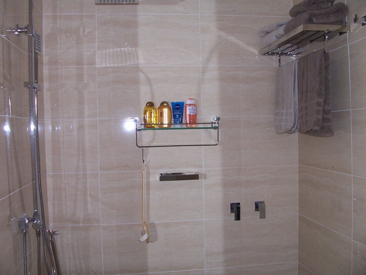

Next picture is the master bathroom complete with TV to watch a show and relax in the spa!!

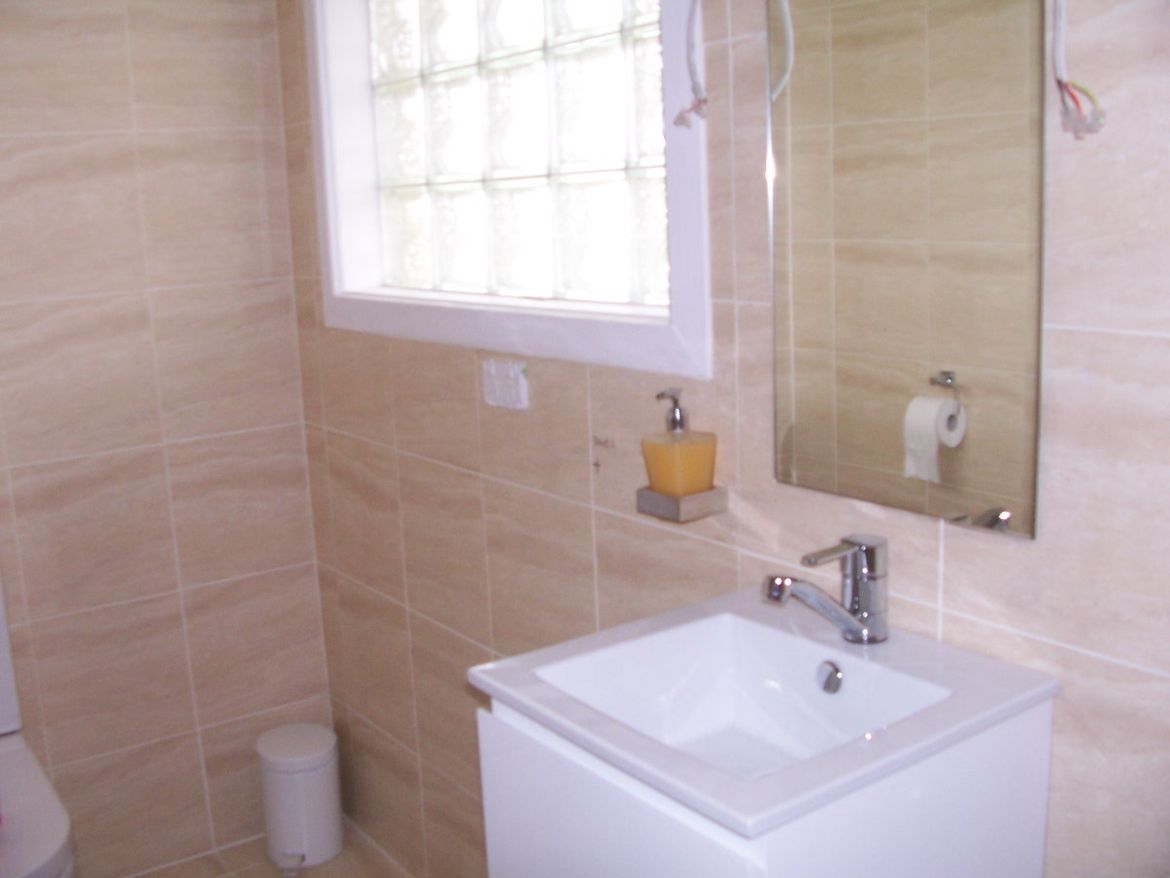

Next photo is the invalid friendly toilet complete with hand basin and hand rail.

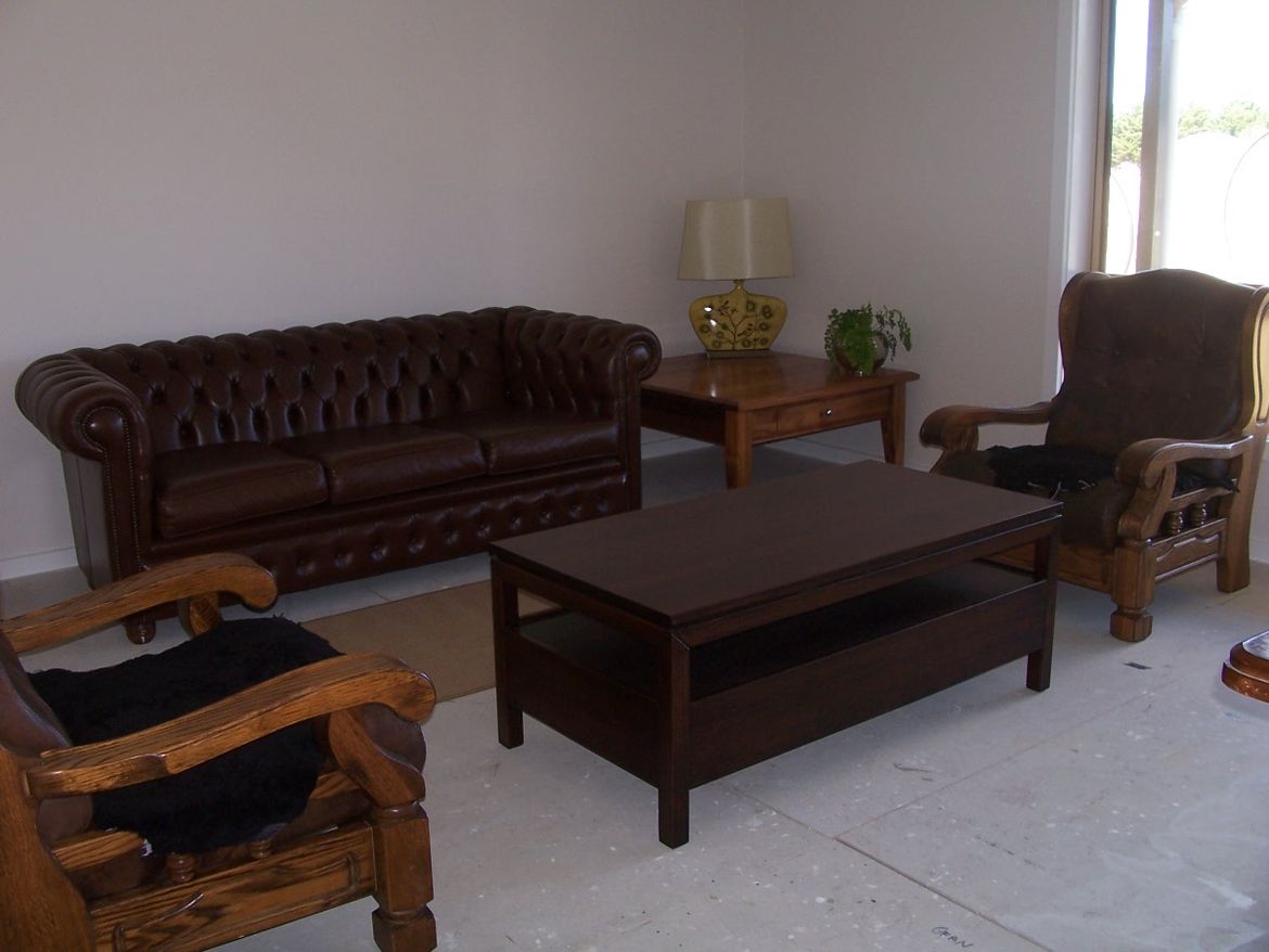

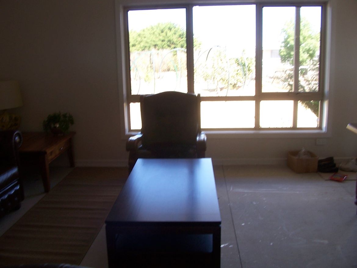

Next three photo's show the lounge, no carpet yet but furniture in place. This room isn't used yet as we still have to get the monster TV!! First pic shows the couch against the laundry wall so east, second pic is due south and third pic slightly south west.
Next pic is the laundry with makeshift bench once again using the trusty green tongue flooring but at least it will pass for the certificate. Just the laundry cabinetry is over $5,000, special water resistand MDF as I understand it!! Dryer yet to be hung on the wall to the right of the towel rail

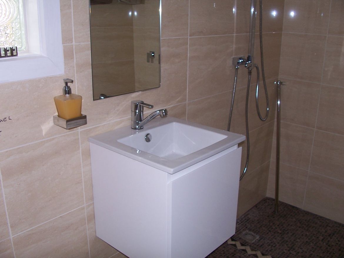

Last photo's show the en suite as I call it, a small bathroom in our indoor pool room.

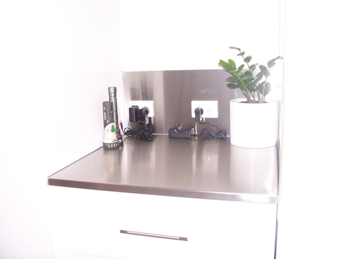

So photo's attached include my completed laundry with stainless benches and splashback.
