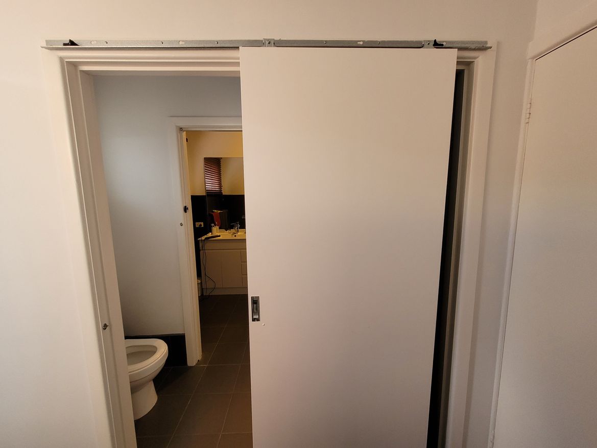

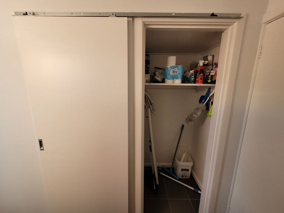

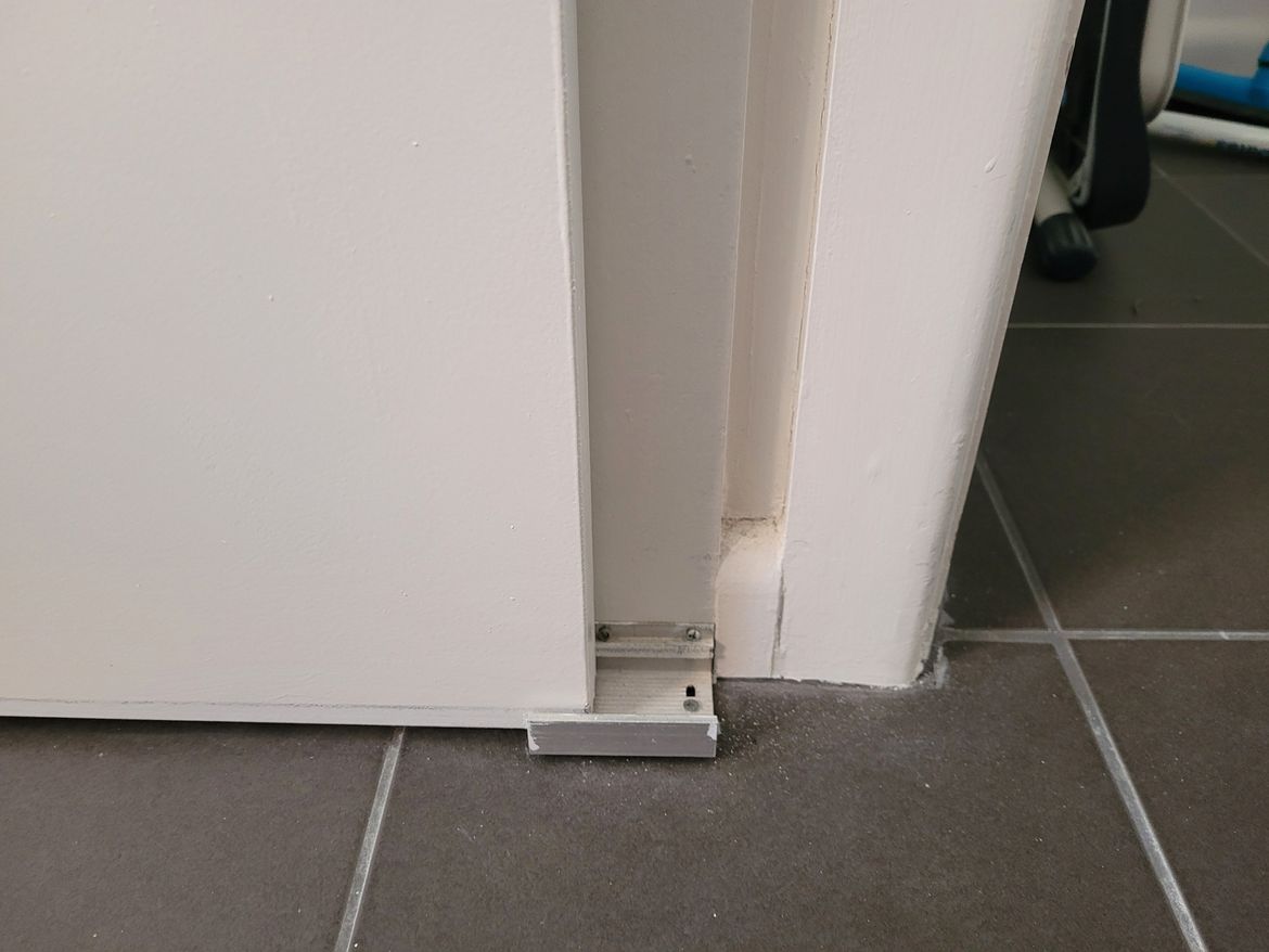

Basic rail fixed to the door casingBasic rail fixed to the door casingFloor guideFloor guideDoor closed off to toilet, opens laundry cupboardDoor closed off to toilet, opens laundry cupboard
