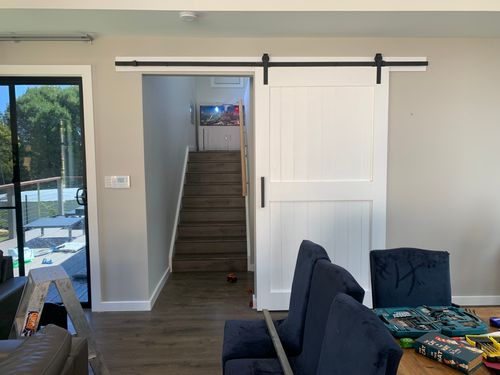

Success. We used five 14G x 85mm zenith screws to mount the 30mm thick timber header and then mounted the rail kit as per instructions and supplied materials.
Thanks for everyone’s input…certainly helped with clarifying what to do.

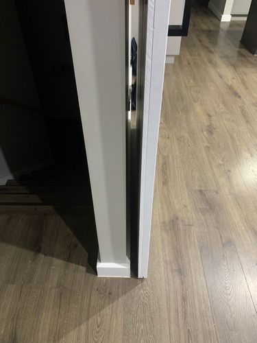

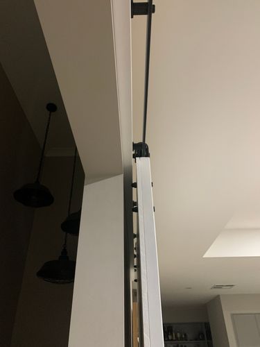

Hi Splinters. As a result of using the 30mm header board, we have about a 60mm gap between the wall and door so the door doesn’t do much to reduce sounds from the other room. However, we have 110mm overhang on both sides of the door and haven’t noticed any wind coming through. However, the door isn’t necessarily close to where we sit on the couch/table…and the blinds haven’t moved from any wind.
If I was to do the job again, I would go with a thinner header board (20mm - I can’t recall the alternative options) so the gap between the wall and door is less. Though I like the sturdy/industrial look the thicker header board brings, I didn’t account for the extra gap from the actual rail system which sticks out another 30mm, hence the total gap of 60mm.
I want to close the gap - whether it be by replacing the header board which will be relatively straight forward, or adding some sort of trim like you suggested. Will be interesting to see what it looks like after it’s done so flick through some images!
In terms of the floor to door gap, it is 10mm which I think is fine.

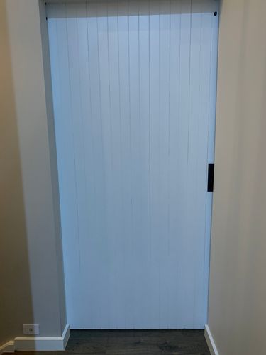

See photos below for the back of the door. It faces a stairwell so wasn’t too fussed what it looked like.
