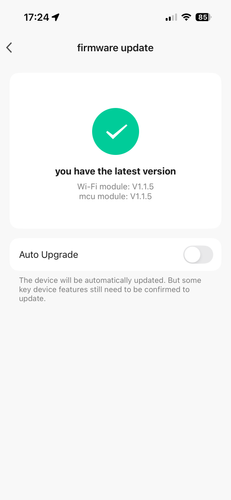

Sorry I never updated this thread. They managed to push out an updated firmware version. I had to give them the MAC address of any which needed it. The new firmware auto restarts the switch when it loses connection to your wifi after a period of time. I only notice it once ever three months or so, the switch turns off for 2 seconds then back on when I’m in the shower.
Now I don’t have to power off my whole house to reset them!!
