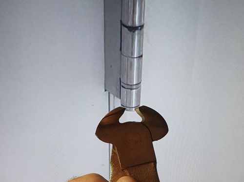

Re: Double door security bolt won't unlock with key
So there's definitely a cap involved with that hinge? Just looks like it has manufactured ends. Joe's video mentions the cap "has" to be at the bottom - but does it?
Have you tried pincers? Both ends?
@Coco_M @If you don’t have a multi tool, a simple hacksaw blade will do the job, it may take a bit longer to cut, eventually it will get through, just wrap one end of the blade with lots of masking tape, to form a handle, then proceed to cut , the hacksaw blade needs to be fine tooth, 32 teeth per inch blade will do the job.
@Coco_M just been thinking if the key keeps on slipping, trying wrapping the end of the key with aluminium foil, this might be enough to take up the slack of the worn teeth inside the locking pin, then try in the keyhole to see if this works
