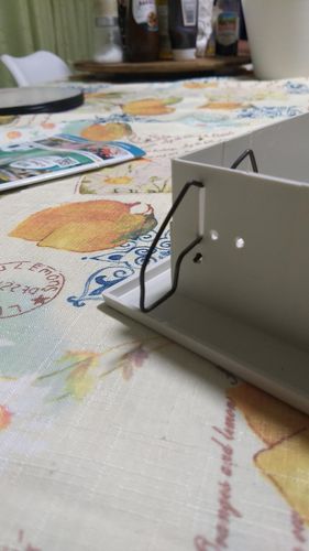

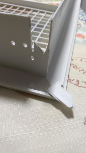

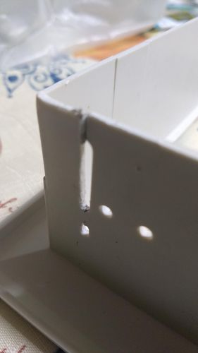

No; I forgot but should have mentioned the plastic cardboard like flaps that are meant as a valve don't work (they don't open when the evap air is on; well not in my house unless the evap air is set to the high setting -  instead of opening the valves in my house on low settings the air as noisily is forced out of the window frame vent slits and other places)  so I simply removed them. The valves plastic cardboard material was simply too stiff to bend and open.  They have changed slightly in their construction since I bought them (they appear they may now have hinges rather than just simple folds in the plastic cardboard like material)  so perhaps they have been improved so they now work as they were meant to. In any event, I believe in summer they work better without these valves allowing air flow even when the evap air is not on. I also suspect with continued use these valves may eventually take a set" at the fold where they are meant to bend and stay open. In any event I consider in conjunction with the whirlybirds, they will work much better without them in summer. There was also a marked drop in air speed of air, measured with the anemometer, coming out of the vents with valves in place so you obviously lose something with energy needed to force these valves open..
Note the original cardboard plastic valve bits are designed to be locked closed in winter but I have doubts about the practicability unless Polyaire has changed the design considerably. The whole grill assembly has to be removed to clip them down from above (unless you want to remove roofing or crawl around in the roof space to do it) and I don't think the grill that I bought would survive repeated removal and installation. These grills have spring clips that push into slits in each corner of the grill frame so the revolve down onto the upper surface of the gyprock ceiling sheets as in the photo below.  During installation, and despite my care, two failed as pictured below.  One continued the manufactured split to the frame edge rendering it useless and another broke per the pictures below.  These retaining springs have a a lot of tension and the take some strong fingers and effort to install correctly.  If I had to do this again, I would consider just using some normal refrigerated air grills instead; something like this perhaps https://www.ebay.com.au/itm/122676272747?hash=item1c90135e6b:g:udEAAMXQuCdTgAVW or https://www.metalflex.com.au/product/return-air-grill-380mm-x-510mm-1311708 .  They might also have the advantage of a grill size that would stop, mice, rats and, most importantly to me, baby deadly venomous  snakes getting through without the need for any modification.The origin grill size on the polyaire product is probably small enough to stop rats and mice but not baby dugites. Baby dugites, despite their small size, are as deadly as the adults and dugite appear to like wintering in my roof space so I suspect they are laying their batches of 30 to 40 eggs up there too.
