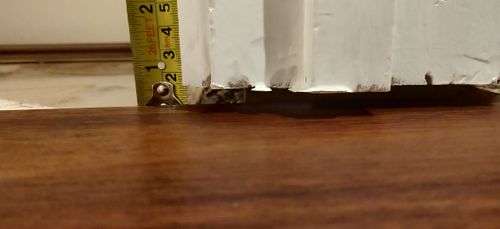

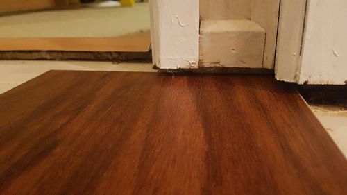

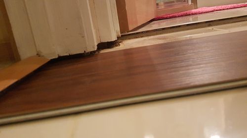

We replaced our timber flooring (14.5mm) with hybrid floorboards (7mm) and realized this has left a ~7mm gap between the floorboards and the door trims/frame. [Clearly we are amateurs in this field and only thought of floor color and not height while purchasing the new floorboards!!] :tear:
Is there a way of fixing the gap without replacing the door trims? Please HELP! :tear: :tear:
any DIY suggestions, if yes could you also recommend what materials we'll need from Bunnings? Thanks in advance for your help!

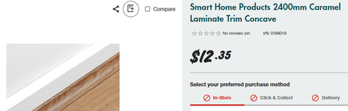

Just to add to .@EricL  advice, Bunnings sell trim the same colour as your timber.
