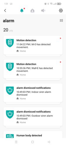

I've just purchased both of these security cameras. Everything works as described with auto pairing (took a bit of blind trying as the manual wasn't that clear) and I'm getting motion detected notifications in the phone app.

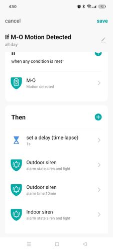

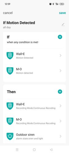

That is until I tried creating a variety of automation based on motion detected by these camera. It just doesn't trigger at all.

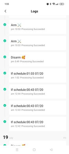

The logs in the automation doesn't show any triggering had occurred. When I tried creating automation based on schedule, it works and the logs shows as well.
Wondering if anyone out there is facing the same issue.
I'm trying to get these security cameras to trigger automation based on motion detected to activate the siren SWS08HA. I was able to successfully trigger the siren based on time schedule as shown above but not the motion detected by any of the cameras.

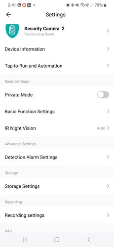

Go into your camera itself and make sure of the following.
Click on Features, top right hand corner then ... , then Detection Alarm Settings, then turn on the motion alarm setting.

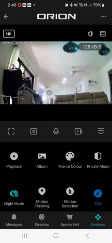

Back right out to the main screen and make sure the Motion Detection icon is turned On.
Give that another try and hopefully that fixes the issue
