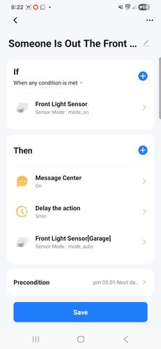

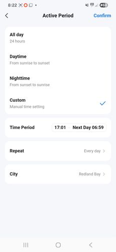

Sorry for late reply I've been under a deadline at work.
What you want to do is set it up like you have, after the light on at a timer or counter and then add the light again with it turning off.
In the Preconditions you can add the times from say 5pm to 6am, there are sometimes other preset conditions in there too.
This should trigger the light to come on for X time then turn off between your precondition times.
