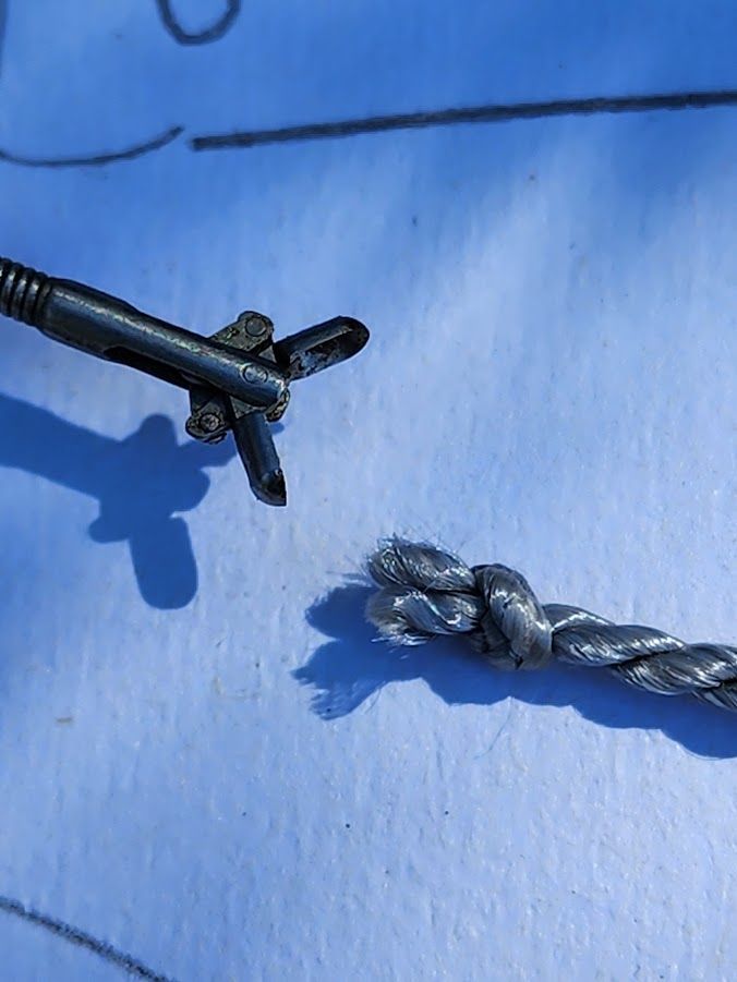

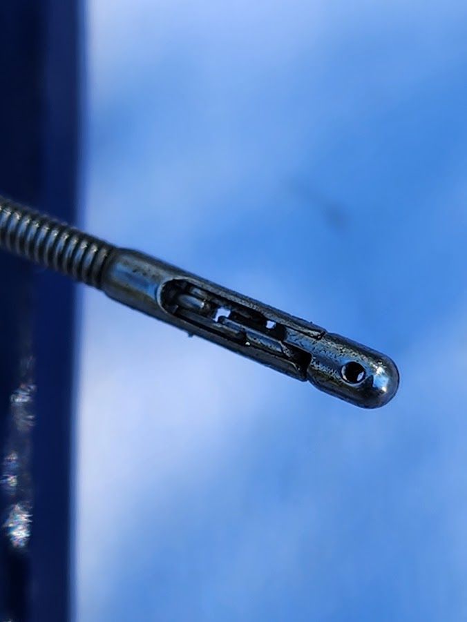

Just a surgical thought @MaxBrenner
Remove the old wire completely.
Feed a colon biopsy forcep (which I can provide you) through the Dragon - I'm thinking the neck area is causing most of the grief?
Grab the end of a strong piece of string/fishing line - and pull through.
Attach a long length to your new cable with electrical tape, avoid creating a 'bulbous' connection as seen above.
Hopefully pull through.

@Noyade , how to get hold of a colon biopsy forcep with serrated jaws like that? Happy to pick up from you if you are local to Sydney. Or I will pay for postage.  At this stage, I am willing to try all the very helpful suggestions here, just to get my old flea market lamp working.
Re: How do I get a new cable up this table lamp?
Hi @Noyade & @MaxBrenner
It's hard to get a scale on things but the Forceps appear to actually be larger than the original cable at the point where they are grabbing the rope. Will that also be the case when grabbing the new cable because that would lead us back to soldering the cables together as it eliminates the friction grab that can easily part.
