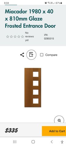

How do I weatherproof my entrance door?
Hi I've purchased 2 entrance doors, one is subject to extreme weather conditions. What should I coat them with to maintain their appearance and resistance?
