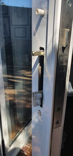

Hi, I'm looking for advice regarding my external door handle on my bifold door.  Recently I noticed one of the screws attaching the plate was loose but no matter what I did it wouldn't grip when I tried to screw it back in. Now the other screw has come loose, and therefore the plate with attached handle has come off .  There's nothing wrong with the screw and the corresponding bit that it's supposed to screw into.  In fact I've take both the back and front plates off the door and tested it and the screws screw in fine.  My problem is is when I'm attaching it back on the door I can't get the screws to line up to grip/attach.  Sometimes I get one screw in but but never both at the same time..  Is there a trick to lining up the screws?  I really don't want to pay a couple of hundred dollars to get a locksmith out just to screw in two screws.  Any advice out there would be greatly appreciated....any suggestions?

So then I came up with this idea which I thought was genius and was definitely going to work.  I cut up a plastic drinking straw  and then cut some slits into the end of it so as I screwed the screw through it it would sort of splay out.  I placed the straws in both holes, pics attached, and thought this is definitely going to work as it’s going to guide the screw into place.  Well, I was jumping with joy as it seemed to work with the bottom screw but for some reason it didn’t the top so I had to pull it apart again, and since that first attempt it hasn’t worked again. I have tried a couple of differently methods now using the plastic straw idea but none are working, including attaching the straw on the threaded part and then guiding the straw onto the screw.  How this isn’t working is beyond me.

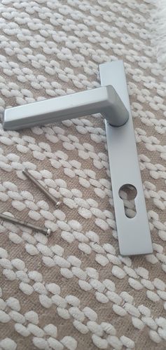

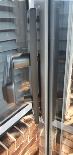

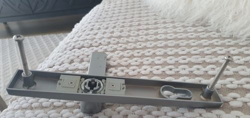

I’ve attached some more pictures, in case you can think of another suggestion, of both the external door handle with the screws attached, as how it should be once installed properly, and the other door handle which can’t be removed from the door but does pop out a few millimetres. If you can think of any other suggestion I would be so grateful.  There is obviously a way of doing this as someone has originally attached the door handle in the first place, and it probably took them two seconds to do it.  I’m on day three now of trying to work this out.

I did take both the screw and door handle to the store yesterday.  She definitely got the right type of screw as even the original screw only rotates two or three times then stops.  I got a M5 x 50mm screw   I even went back and purchased a M4 x 50 mm just in case.
Thank you about your suggestion re the butter knife but it's a bit too thick.  I have used a paper clip but to no avail.  Here are my last two attempts using different types of straws, one paper, one plastic.  In these pics the screw is in the straw.  The paper straw is moveable so the idea is it pushes in when the screw starts screwing.

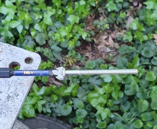

A bit of blue tack from the freezer (if warm - then it's too soft) and squeeze the bolt onto a Phillips head battery driver with the blue tack.
Work quickly. "Insert and engage" as quick as you can with the driver. It may take multiple attempts.
I do know (and have somewhere) they make hand held screwdrivers that 'anchor' the screw to the head with clips.
Even better, maybe a strong earth magnet (mine is from Jaycar).
The door should be mostly alloy and not affected by the magnet (theory).
Just use it as a screwdriver until the thread engages.

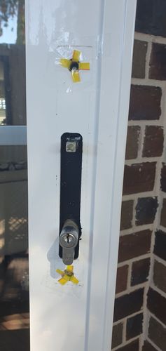

Thank you for your interest, suggestions and photos, but I think you've misunderstood my situation.  I have access to the screw's head.  It's when I go to put the external door handle on with its attached plate  that I cannot longer see the end of the screw that needs to go into the female thread, which is on the external part of the door handle.    The screw is shorter than the width of the door and drops down inside the cavity of the doo therefore I have no control or  understanding of whether the screw is 1 or 5 mm out. It's very frustrating.  If it was an internal door I wouldn't be as concerned but it's an external door and it's the only way I can access my backyard.
I gave up last night and just put masking tape on it for now, lol.
