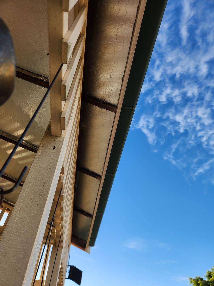

Is it possible to get some photos of the soffit that you are referring to?

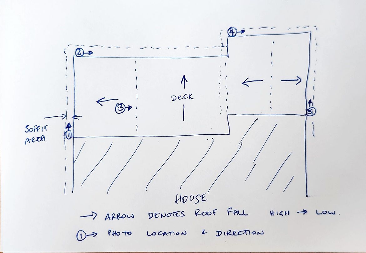

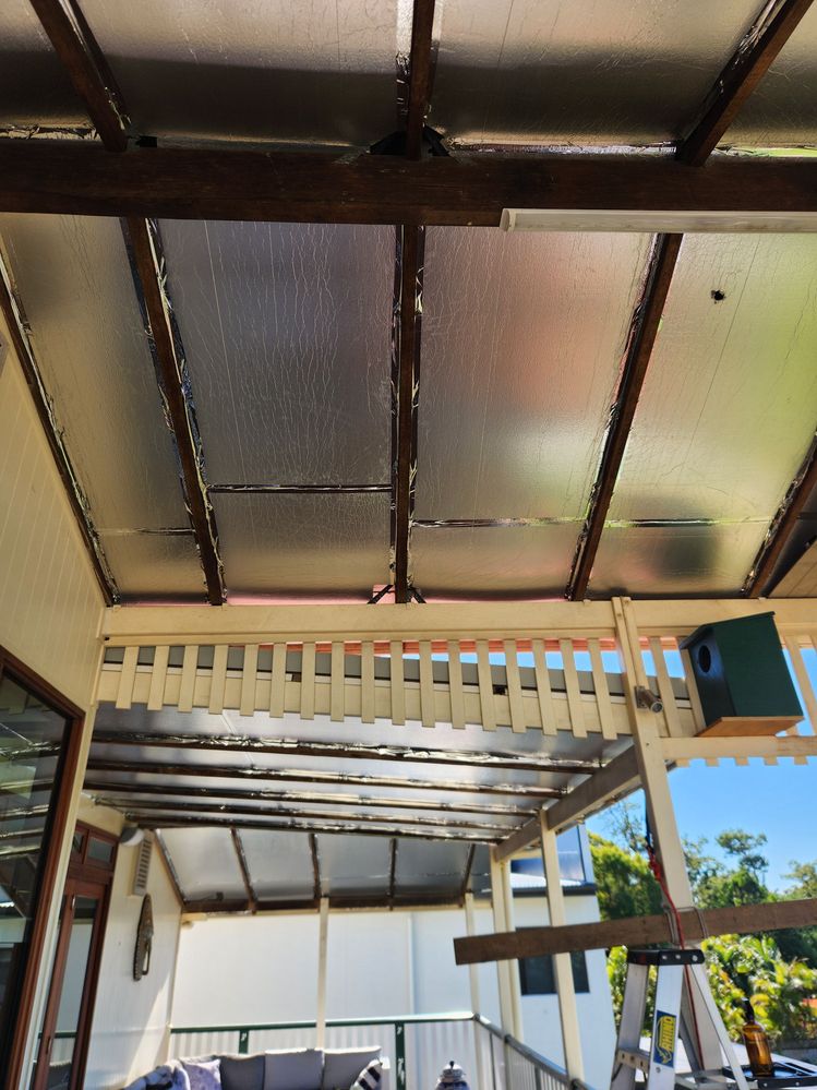

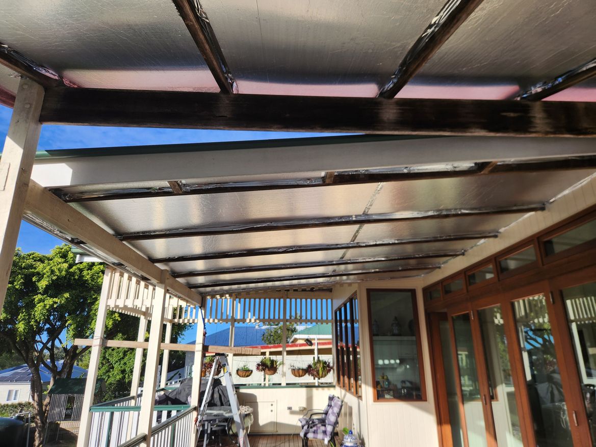

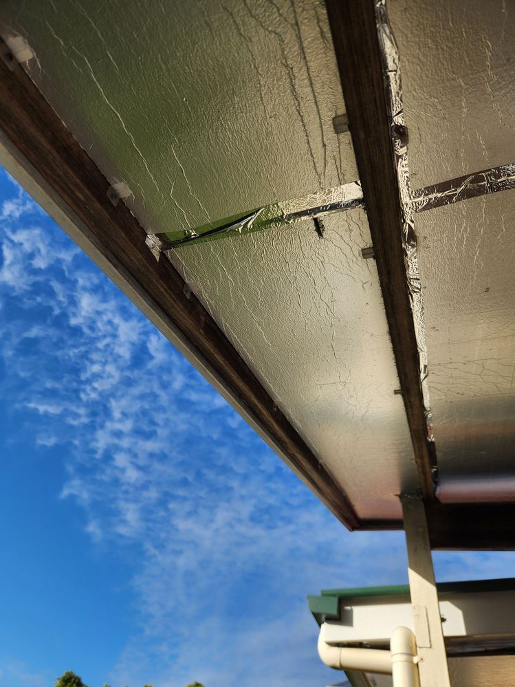

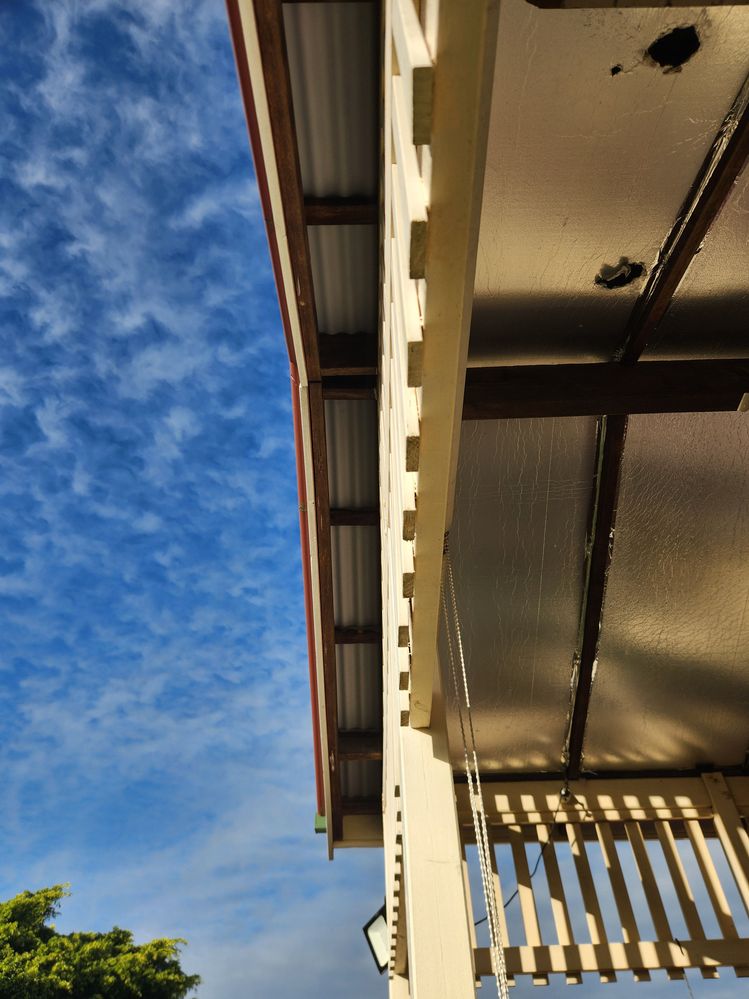

JacobZ, Thanks for the information. I attach a few more details, including a sketch plan of the area, and photos of the "soffit" area. I've looked into some of the suggested products - the quick board installation guide prohibits installation within 300mm of roof, so it won't work and I want timber look in a natural colour, so FC planks are not suitable. Plywood and pine lining boards are the remaining options, although for completeness, we might also consider VJ board, painted, as that would match our internal ceiling.

2) there is a difficulty with the detail at the fascia, as the bottom of the fascia is only about 20mm below the rafters. Originally I thought the metal battens could be notched to sit flush with the bottom of the rafters, or alternatively much more work, would be to install timber noggins between the rafters (cut to size and skew nailed). Timber or metal rafters sitting proud below the existing rafters are easy to install, but the lining would then sit below the fascia - possibly that could be weather proofed with an angle flashing but interested in any other ideas. Alternatively, I calculated the weight of the timber lining and it is light at around 20kg per bay (between the rafters, 900mm centres and max 3.6m long, with some bays shorter). So question is whether new "battens" could run parallel to the rafters, and flush with the bottom of the rafters? For example, run 70x35xmax 3.6m long parallel to rafters, supported at ends by roof framing (and if insufficient support, perhaps a noggin halfway).

Is it possible to get some dimensions for each of the different ceilings?
I ask because, it is likely possible to order lengths of pine lining, such as the 138 x 12mm 4.8m Pre-Oiled Clear 302 Laminated Pine Lining Board that can span the full ceiling so there'd be no need for any joins.

When you can't use a batten because of the height of the fascia in relation to the rafters, I think the only simple solution is to add noggings. I understand it will be a fair bit of work, but the only other idea I can think of is to replace the fascia with a wider board so that it hangs lower and covers the edge of the timber.
