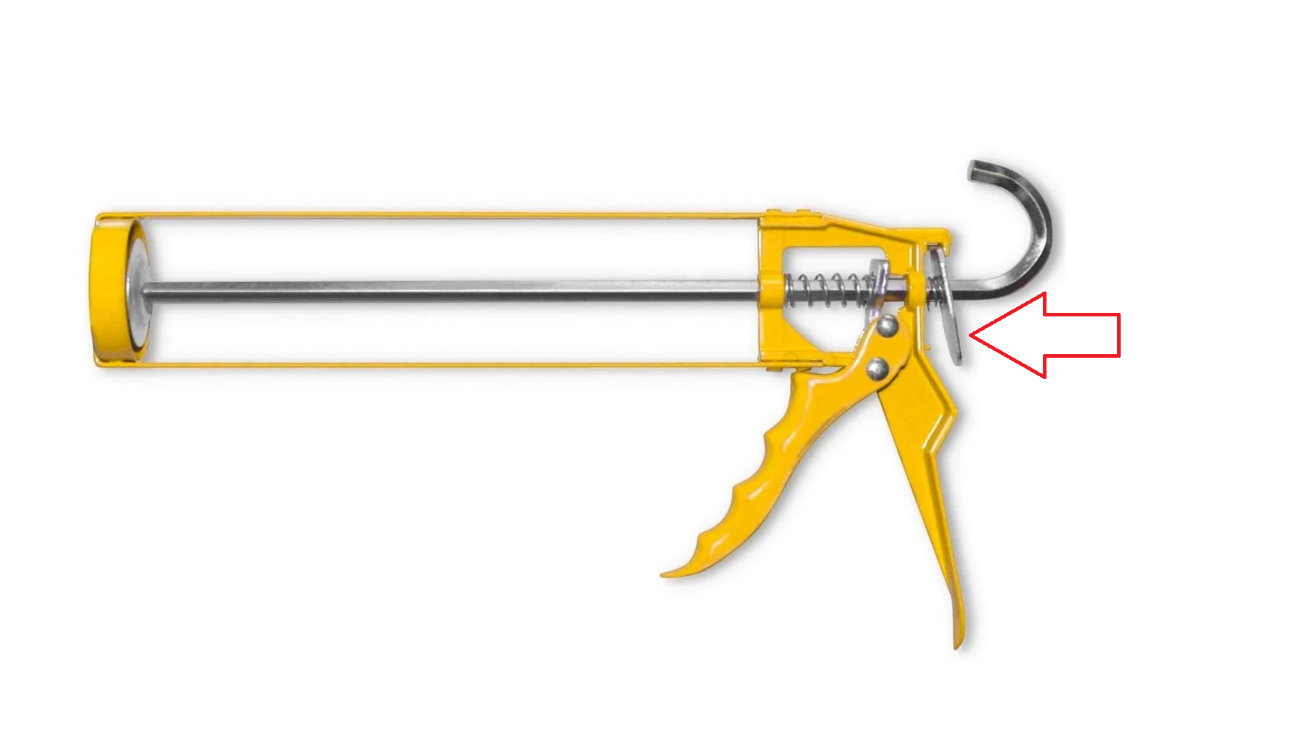

"One thing to note is to have something to rest the caulking gun on (A piece of junk mail say) so it can ooze while you get ready for the next section as the stuff can be a pain to clean up." Top tip @Dave-1. For others reading this discussion, whenever putting the caulking gun down or if excess is flowing out of the nozzle, always depress this lever on the back of the gun, which releases the pressure and stops the caulk from flowing.
