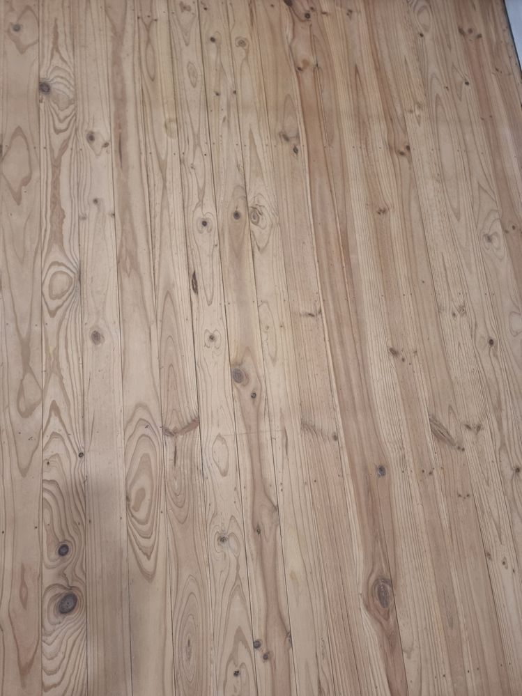

We recently purchased a 1960s build brick house with timber flooring, After removing all of the carpet we have found that 1 rooms floor has not been finished like the rest of the house and was left as raw timber. I have sanded the floor down now and i'm looking for some experience with picking what type of timber this will be?
We are going to try match it into the rest of the flooring colour but havent had luck with nailing the colour off the tester pots that i have laying around in the shed (Walnut and a light oak) so any pointers towards colour will be awesome.

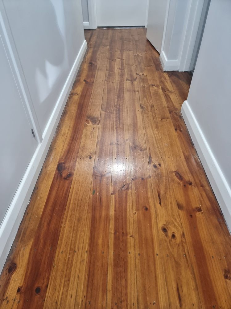

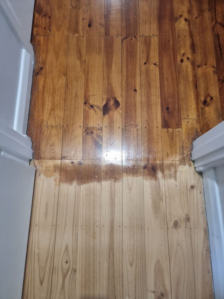

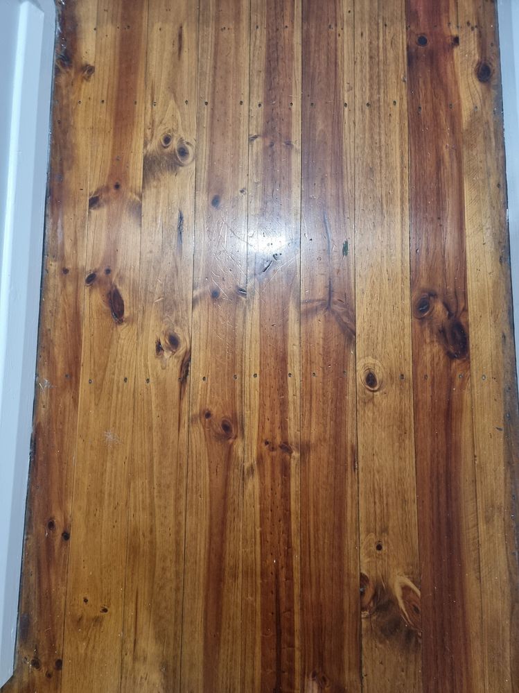

It’s likely that your timber flooring is cypress pine, especially if it’s original to a 1960s house. If the rest of the house has its original coating, it’s probably an oil-based polyurethane that has yellowed extensively over time. Matching old coatings can be tricky, as not only might the original product no longer be available, but the colour has likely changed significantly with age. Oil-based coatings from that era were notorious for yellowing, although modern versions are much less prone to this.
I’d recommend starting with the oil-based version of Cabot's CFP (Clear Floor Polyurethane) and testing a small, inconspicuous section of the floor. You might also need to use a stain underneath it to achieve a closer match to the rest of the house. Keep in mind, though, that perfectly matching the colour can be very difficult due to the ageing process of the existing finish. This might turn out to be a situation where you need to sand the entire floor back and then apply a consistent coating throughout the house.

Thanks for the reply @MitchellMc, i might see if i can find a yellower stain to combat the old coating yellowing over time so it gives me a good starting point!
I would love to sand the whole floor back by time doesn't permit for now so just trying to match the sanded floor to the others.

Maybe you have found the match by now, what you have there doesn't look too far off.
It's better to use a test sample piece than directly on the floor until happy.
I'm about to face the same thing.
Wanut & light oak are likely the closest option for a close match.
Be sure to measure what you test out so you can prep the polyurethane clear coat once happy with test coat on a sample.
