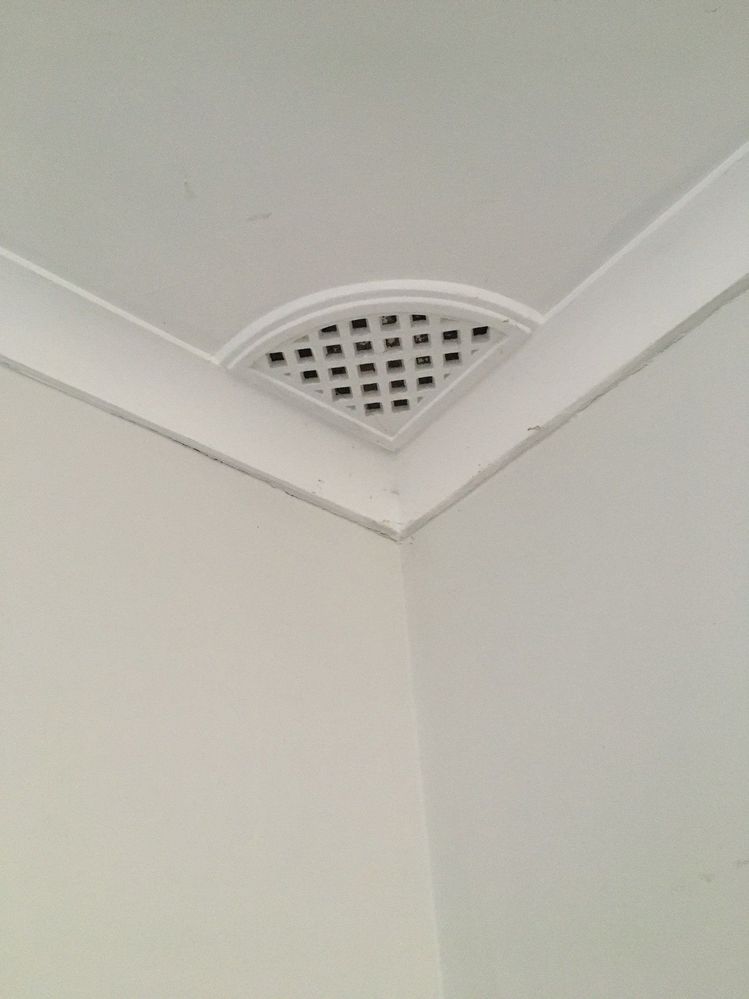

I have ceiling moulds in the corner of the ceilings that are perforated.  Any ideas on simple ways to either cover or seal?  They let in a lot of dust!

I suspect that this is a form of ceiling ventilation that is linked to a whirlybird on your roof. One way to cover it is to use a Project Panel White Corflute - 900mm x 600mm x 3mm in combination with Selleys 100g Clear Ezi Press Wet Area Silicone Sealant.
I suggest tracing the area of the ceiling mould that you wish to cover with pencil and paper. Once you have the shape cut it out with scissors and place this shape on the corflute. Trace the shape on the corflute and cut it with a Stanley Knife.
Once you've cut the shape you need. Put a small bead of the silicone sealant close to the outer edge of the corflute. Push your cut out cover onto the mould, I suggest putting on some masking tape in the corners to hold it in place until the silicone cures. Once dry make sure to remove the masking tape.
There are other methods such as cutting the mould out and re-plastering your ceiling, to using plaster repair sheets to cover the holes on the mould. This method I've suggested is the quickest way to cover it without spending too much on the project.

I don't think they are related to ventilation as there are 4 in each room as well as two other big vents above bathroom and laundry.
