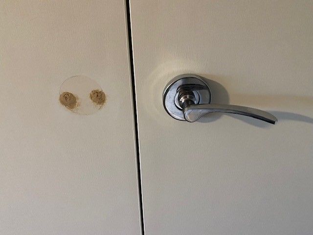

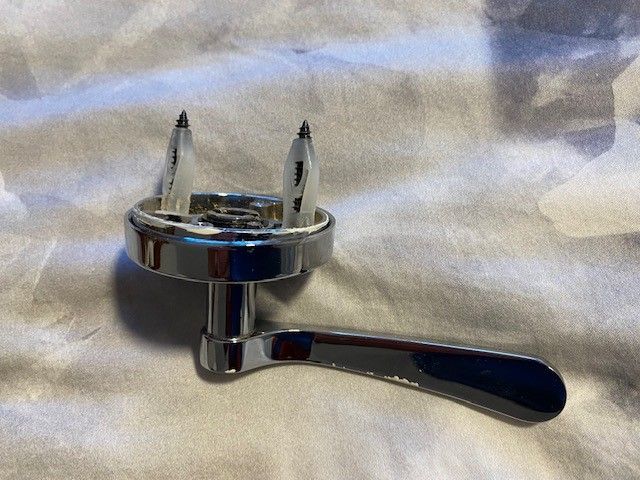

Hi Eric, and for your interest with my issue. I am not sure what the door material is exactly. I am sure it is not solid timber, and I suspect that the door is likely compressed fibre. I've tried a couple of patch types (Plastic Wood, etc) but they don't seem to hold. I've also tried a couple of plug types to see if I could get something to open up in the cavity (three different types now, plastic one, a metal one that has a point to adhere it to the door, and one that was to have butterfly opened) all with no success. The entire house uses these types of handles, so I don't want to get into having to use a new type/style if I can avoid it. I suspect that the doors may have been custom built for the house, as the wardrobe is built in under a loft in the bedroom. Non of the other doors in the house are like the wardrobe doors - they are more of your traditional construction and much more sold (no problem with them).
Thanks in advance for whatever recommendations/help you might have.
The pictures are attached.
Cheers!
MarkDoor (with my latest plastic wood patch)
The handle with the latest plug I tried

Thank you so much for posting those photos. After much deliberation, I suggest drilling through to the other side of the door and using a Pinnacle M8 x 50mm Zinc Plated Round Head Bolts And Nuts - 4 Pack in conjunction with a washer that is one size bigger. I'm recommending this repair method because the current holes in your wardrobe door are already too big.
The steps involved in the repair would be to bring the mounting plate to the store to make sure that the threaded screw you choose is big enough that it does not fall through the mounting hole of the mounting plate. If the screw pack includes the nuts, then all you need to match it with is a washer that is one size bigger. The purpose of the washer is to make sure you don't over tighten the bolt and nut assembly.
I have included a diagram so that you'll have an idea of how it will be put together. My number one tip for this repair job is to put one drop of Loctite 5g Precision Liquid Super Glue after the nut has been tightened into position. this will prevent the nut from being vibrated loose with the constant pushing and pulling.

Hi Eric, I finally was able to get to Bunnings and talked to one of the folks (David) in my store about my problem and the solution being proposed. David suggested that I alternatively try something called a Lane - Dummy Lever Fixing Set, essentially a dummy back plate with locking screws for the door lever and...it has worked out perfectly! The dummy lever fixing set was inexpensive, and took about a half hour for me to measure, drill, and install. My wife is so happy with my new found skills - and here door working at long last
lol. Thanks again for everyone's help in getting this issue fully resolved. I am likely to be back within the next week to by 5 more of these fixing sets for the rest of my wardrobe doors. Cheers! Mark
