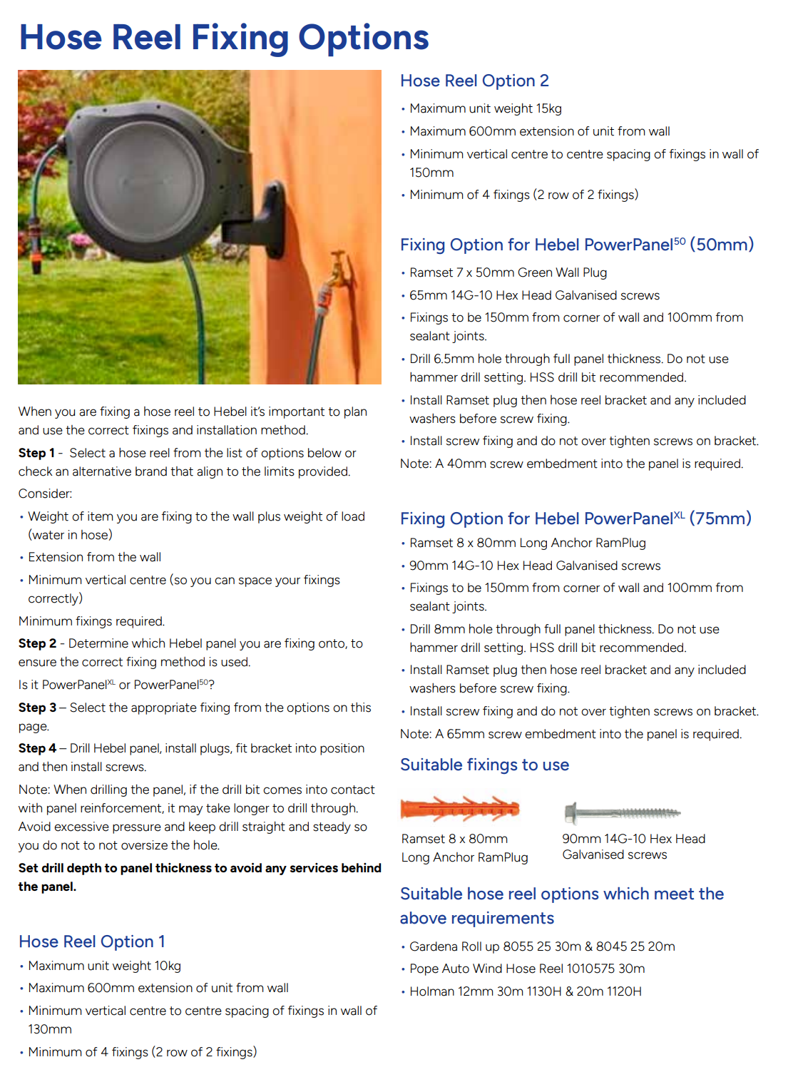

Hi @ajperry,
It's great to see @Dave-1 and @R4addZ have already jumped in to assist.
If you aren't able to install a post, then the only real option is to attach the hose reel to the wall. The only options I can really provide are those that are in the Fixing to Hebel Guide that R4addz mentioned above.
I'd be looking to use the method shown in the Fixing to Hebel guide above. You'll note that these methods mention specific hose reels', maximum weights and length of extension from the wall. If your hose reel is not one of these reels that are mentioned, or it weighs too much, or extends too far from the wall, then you may have to look at a different hose reel.
Are you aware of what type of Hebel panels were used on your house?
Assuming your hose reel fits within these requirements, if, for example, you have Hebel PowerPanel XL, which is 75mm thick, you would use these Ramset 8 x 80mm Long Anchor RamPlugs with 90mm 14G Hex Head Screws. If you have Hebel PowerPanel 50, then you would use Ramset 7 x 50mm Green Wall Plugs with 65mm 14G Hex Head Screws.
Unfortunately, if the existing holes have blown out and they are too big for these fittings, then you'd have to move the hose reel slightly, fill the existing holes with a filler such as this Polyfilla Exterior Brick and Render Masonry, then paint the patches to match the wall.
