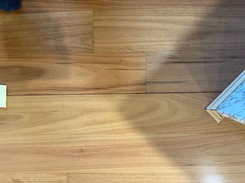

Have an engineered timber floor that’s about 5 years old and notice a gap is increasing between some of the boards. Any simple fix?

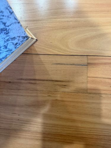

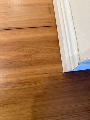

thanks for your reply and suggestions. Yes it’s a floating floor with some sort of engineered timber. The nearest parallel “wall” is a kitchen cabinet about 3 meters away on one side and maybe 5 metres to a wall in the other direction. There’s a few angles  from the edge of the kitchen cabinets. The first photo shows how the plank has been cut around a wall, the second and third photos show the other edge next to a cabinet

as @JacobZ mentioned there is no easy fix here unfortunately. Thinner floating board products have very shallow connections that can easily seperate if the floor isn't prepared exactly as they are very unforgiving. Same goes if there hasn't been an expansion gap on some ends. And the connecting edges can easily crack/split during installation unbeknown and later can cause issues like these.
End to end gaps can sometimes be fixed if not far from the wall by removing the skirting and prying the board end. But I don't have a proper fix when on the edges. that doesn't require pulling all the boards up, which also isn't practical.
What I have done a few times that appear to have prevented further separation with a cosmetic finish is this;
1.Use quality painters tape all the edges of the separated board sections.
2.Apply a thin bead of high-strength wood glue and use a spatula to press it in. I then used a hair dryer on low with no heat to push the glue in as far as possible. Then repeat if possible.
3. Use a damp cloth along the gap to remove the top 2mm or so of glue and allow to dry.
4. Fill the gap with a best possible match of the board colour with a timber floor gap filler.
5. Wipe the excess and remove the tape.
It's an easy affordable DIY solution, worth a try and you have nothing to loose if its unsuccessful. If we can stop the boards from separating further, then it will prevent others from potentially doing the same.
