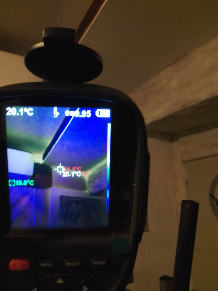

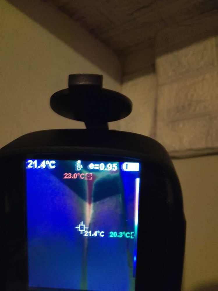

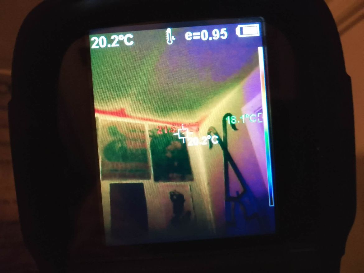

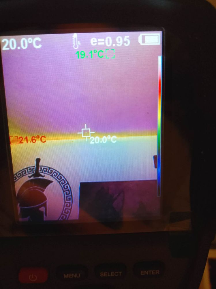

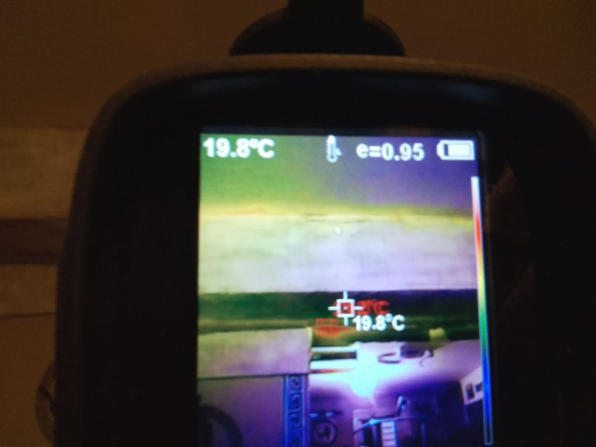

Still problem areas, what would be the best way to address these hot spots?
Hi, I would like to ask your advice. These are photos from a garage that has been converted into a room, the outer wall and the upper part of the roller door has foilboard (that has been painted ). I've used silicone to seal gaps but I can see there are still some unevenness. On the roof side I applied spray foam which I could put more unless you recommend something else?  I used plaster or silicone on the corners but that may not be as heat resistant? The first two photos is showing a hotspot on top of the mirror it has foilboard and silicone. It is strange as behind the mirror is two stacked MDF boards and insulation batts behind it, I cannot think of a reason for such random leak. How to best address these spots without needing to rip off the whole board?
Your advise would be much appreciated. 3caa1edd-cbb7-45ae-b75f-74c411d6d476.jpegfefb48d7-1f61-4ad6-910b-c4e2c01de0ad (1).jpega6163243-bb6a-4408-b93e-0f007112b5db (1).jpeg7b723a2b-c527-47f1-8d41-415836f39204.jpeg98dde804-2a35-45b2-be87-7b9827b6ee18.jpeg767acb92-419c-4da9-81dd-83e4d5507a21.jpeg9c57b7ea-d286-4f06-80e7-7ac2150c3836.jpega6163243-bb6a-4408-b93e-0f007112b5db.jpeg

Re: Still problem areas, what would be the best way to address these hot spots?
Hi @Vitriolum,
Given that this is a converted garage, it’s important to remember that garages aren’t designed as habitable spaces. Even with insulation, some heat transfer from the outside is inevitable. The small hotspots you’re seeing, like above the mirror or around corners, are relatively minor and, in most cases, won’t noticeably affect the overall comfort of the room. In fact, a standard new build with higher R-ratings would also show small discrepancies like this if you looked closely with a thermal camera.
You’ve already done a lot to address the main areas: sealing gaps with silicone, using spray foam on the roof side, and plastering corners. These are all appropriate steps, and trying to chase down every tiny hotspot without removing boards or doing major structural work would likely give minimal benefit. The differences you’re seeing, often just a degree or two above ambient, are quite common and acceptable for this type of space.
In short, you’ve adequately addressed the insulation for the room, and the minor hotspots are normal for a converted garage. Unless the temperature differences become much more significant, the current measures are sufficient.
