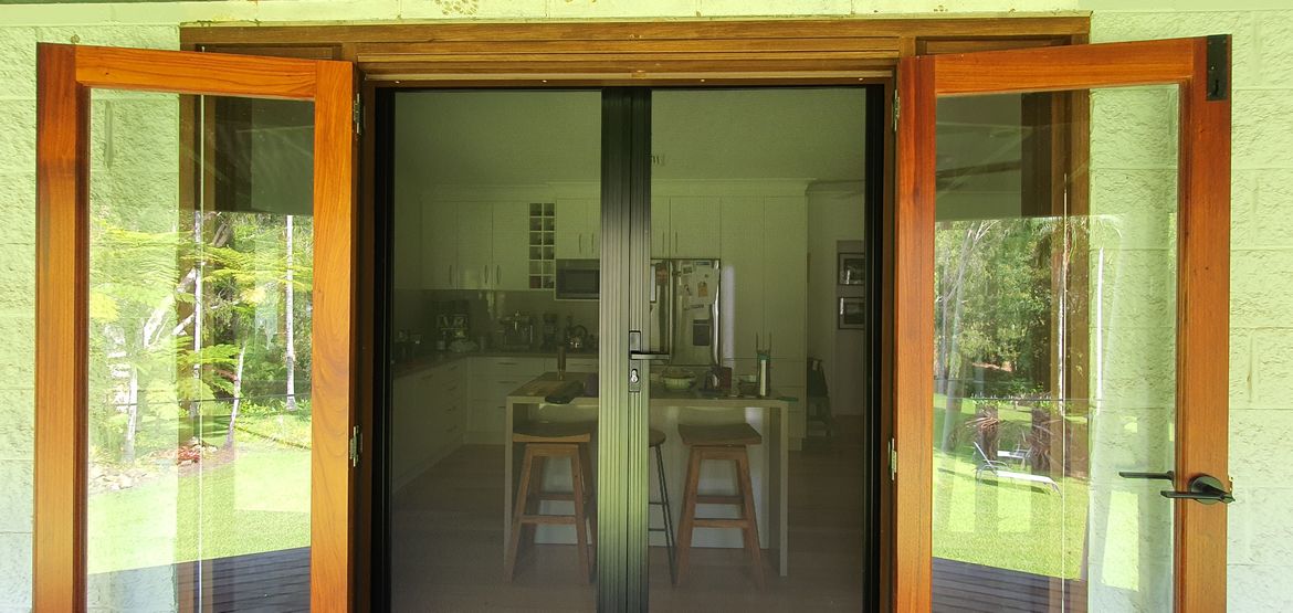

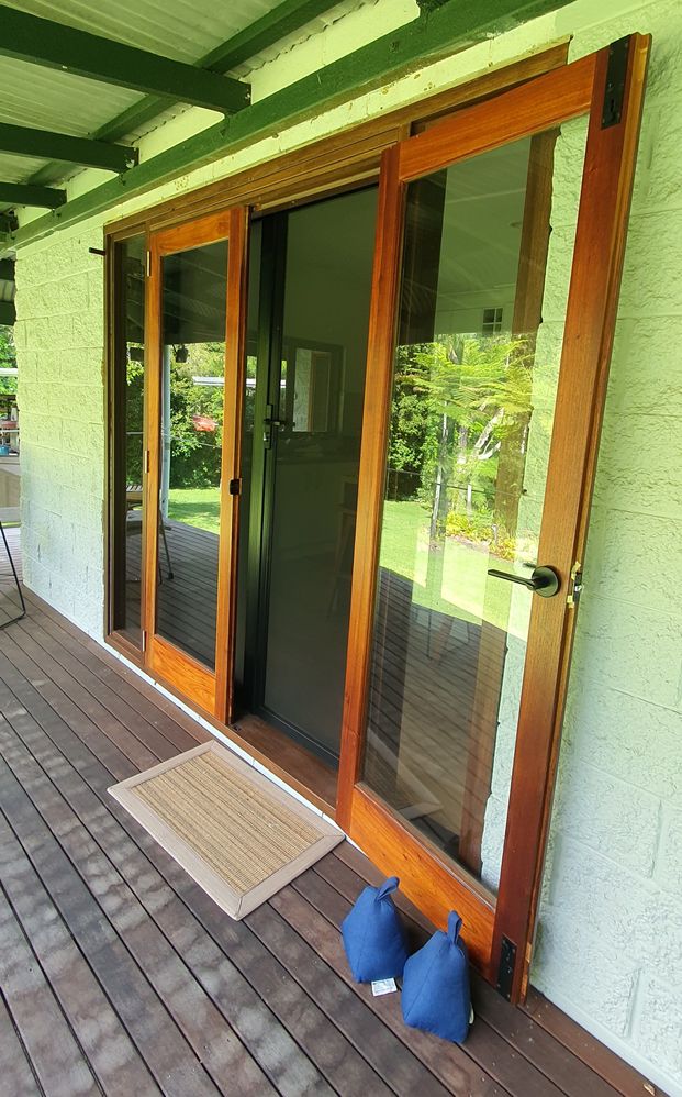

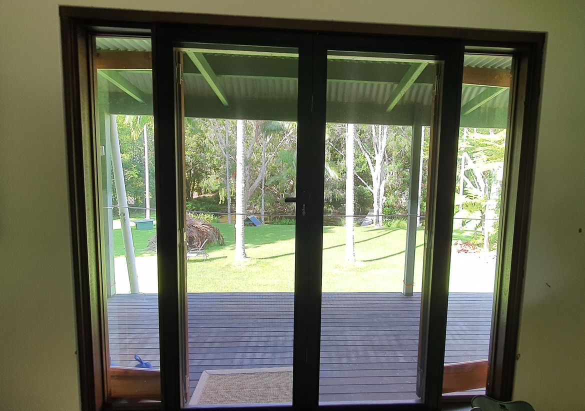

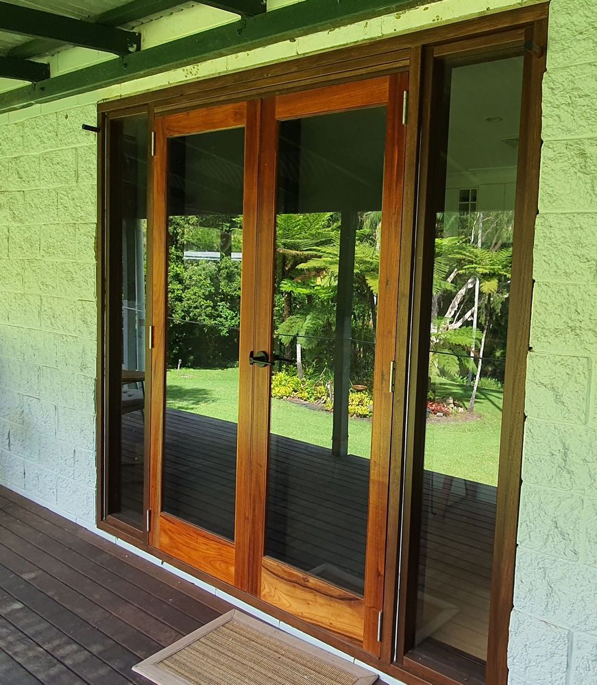

The doors were in for a while before we could get the screens in, and we still have some trim to install as well as the latches to secure the french doors when open. I cut, rebated and installed the timber frame and doors myself (with some blokey help here and there), but we got a local screen mob to install the security screens. The french doors were not the same height as the opening, and I opted to install the side lites to the full extent of the opening rather than reduce the light. I'm still going to do something decorative to hide the frame above the doors, just not sure what yet. One mistake made was putting stick on foam door seals - they are awful, and now almost impossible to get them off.  We'll be replacing those with better quality door seal strips.
All in all, really happy with how they turned out. (Note - before committing to purchase old french doors check how they will connect - this pair had to be hung with the beading on the outside for them to work with the screen and I would have preferred them the other way round).20260103_152125.jpg20260103_152213.jpg20260103_152244.jpg20260103_152416.jpg
