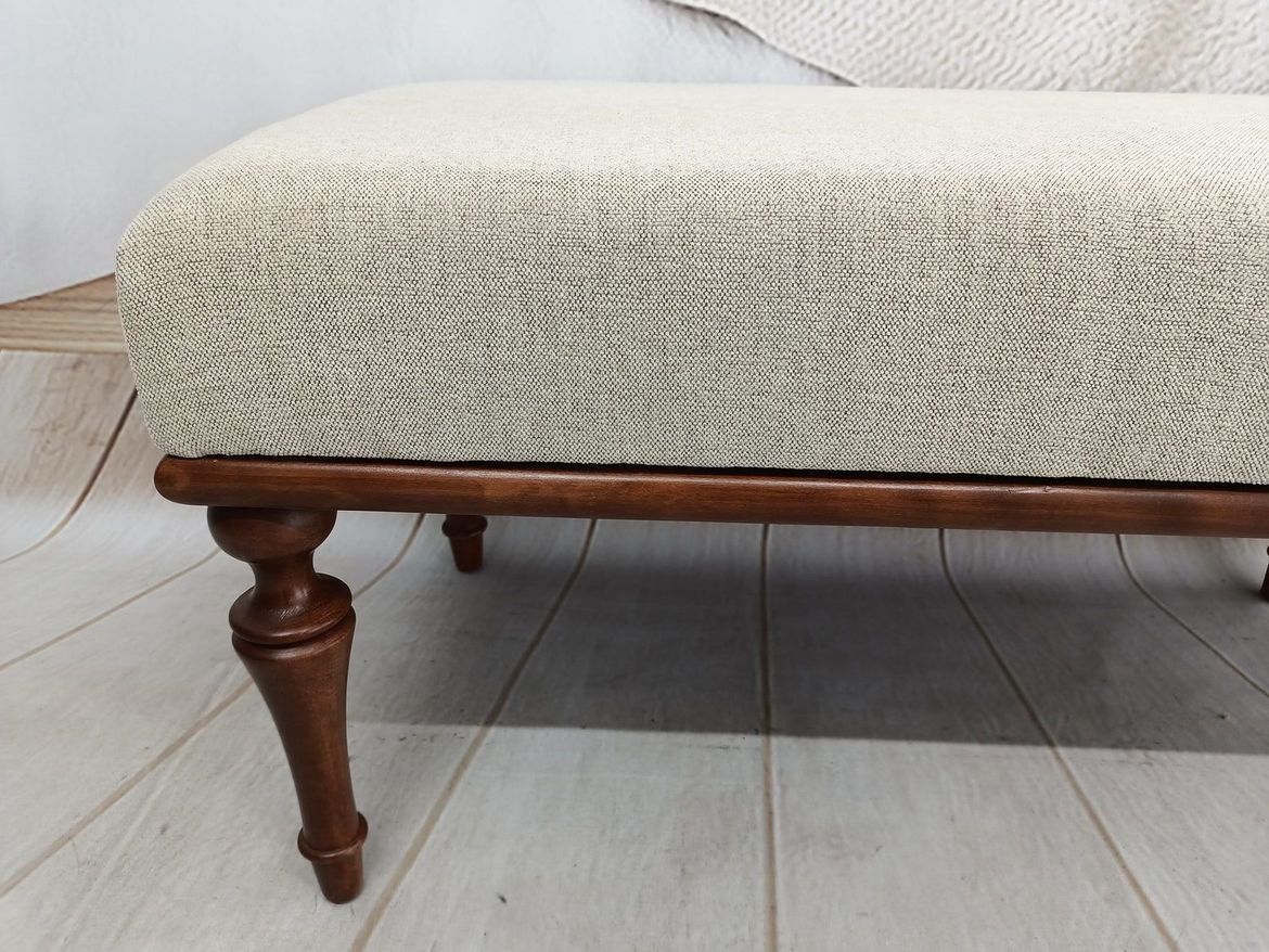

Please see image for reference

in terms of "cutting and shaping of the timber itself to assume the look and feel of an antique piece" - I think i want to keep it simple and make the seating shape a straight up rectangle. The vintage look will be achieved via the legs and the upholstery used.
What I am confused about is when I make the frame, how do I attach the legs to it as the middle is hollow?
Will I be using legs with an L shaped mounting face? If I use what you suggest, how will be able to do that with a frame where the middle is basically nothing.

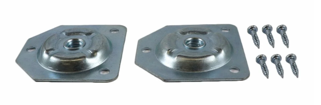

I've placed a sample image of the mounting plate below to show you how the legs are attached to piece of furniture. Please make sure to get the correct size of plate and leg to make sure they fit each other.

Going through your question I was thinking of how would I attach the legs myself. Then @EricL showed a very nice solution :smile: I was thinking of a longer bolt down into a threaded hole on the leg itself.
