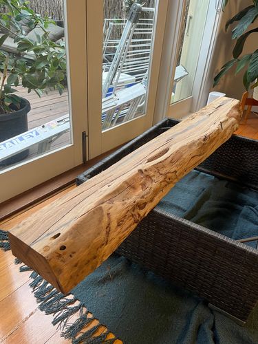

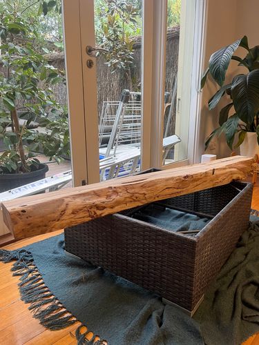

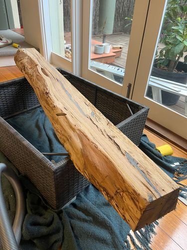

Out of interest, please check out the pictures below, just wondering as I’m not sure how much to sand the live edge part. Interested on recommendations on if I should start staining/oiling the edge now or if it needs to be sanded back more? Cheers.
Re: How to remove excess black knot filler from timber mantle
Hello @Plantos
I suggest doing a water bead test on the surface of the live edge to see if it still needs sanding. Turn the timber mantle on its side so that the live edge is pointing up and is level. Put a few drops of water on the surface to see if it beads up or slowly gets absorbed by the wood. If it gets absorbed by the wood, you can start staining/oiling. Please note that some parts of the surface will still repel the oil/stain, these sections will need to be sanded further.
