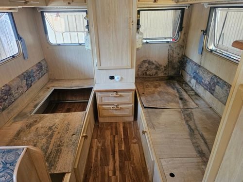

I am so very lucky AI brought me to this helpful site. My husband and I have been given a 2004, Millard Horizon special edition. Unfortunately, it has been leaking for some time and mould is very apparent near the left bed. My husband has already made a great start on it and we are on a bit of a deadline to make it work.

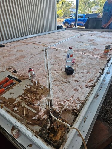

My husband has already taken the roof off and we are waiting on the ceiling to be delivered. We also got a new sleeve made by bagsnswags - amazing - less than a week turnaround and only $700.

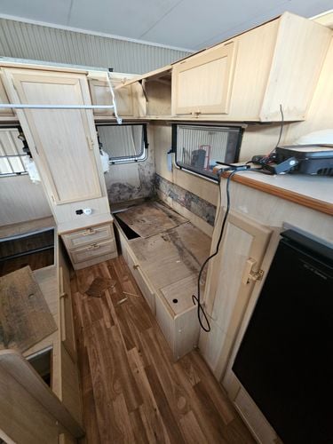

Now we are looking at the interior and I really need someone to help me with the next steps in fixing the areas where the mould has penetrated. I am at a loss as to where to start.

My first thoughts were that the mould has probarally entered the timbers, Maybe replace the underside of the lounge seats with new timbers? But then the walls... Mmm I have seen paint for ceilings that kill and cover mould but not sure how much it would kill mould embedded within laminate timbers.
Is the wall a shiny surface or is it a porous suface? If its a shiny surface then maybe the mould can be removed resonably easy?
Another question comes to mind, Are you repairing like for like or are you going to change the inetrior design around? If you change the interior around it may solve the removal of the mouldy timber as you remove it for the new layout?
I would have a look at mould killing paint for teh surfaces you dont want to remove and replace all the loose pieces of the beds/lounges as the easiest course of action.

I would say the mould has come from within the walls so all the way through the ply, I would advise removing all of the affected timber and replacing. Are those rivets I can see holding the panels on? If so, then aluminium frame and great news, if screws, then there would be worse damage behind the ply. I would drill the rivets out and carefully cut out the affected ply and use it as a template to replace with new. I find a multifunction tool great for this job, just be careful to keep the blade very shallow so nothing else is cut - eg frame, wiring, outside cladding (yes, I've seen a few novice renovators cut right through!)
Depending on your location, you may be able to source caravan ply locally via a plywood supplier or somewhere like The Bunker, otherwise try special orders at Bunnings (Forest One supplier), or you could use 3mm ply from Bunnings and paint the whole interior to match in. Caravan ply is often poly or paper coated and 2.7-3.2mm thick and very lightweight.
Have you resolved the leak? Taken out and resealed the windows with new sealant, also trims/j rails and anything else that may have caused the damage?
Also check the back corners of the floor to make sure water hasn't penetrated and caused any rot there, it's amazing how far water can travel in a caravan from the actual source.

Thank you so much. Yep wood is porous. Great idea about the paint, thank you. Not sure if we are going to rearrange the space. I think we may have looked at that, but we've got a deadline to get it ready to go late November.
