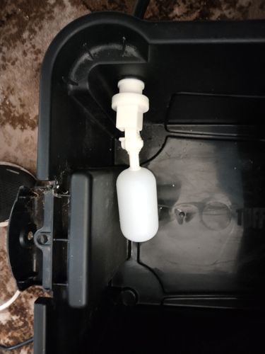

The float valve regulates the nutrient into the reservoir container...When the level drops the  float valve opens and nutrient is added from the header tank..

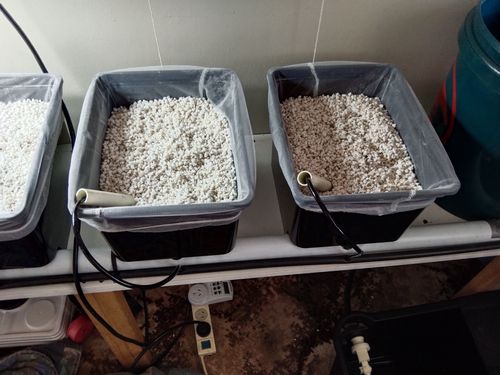

The buckets have a small drain pipe in the front which is fitted into a hole in the white run off pipe..You can just see the holes in the PVC tube..
Below in this photo is the timer unit which controls when the buckets receive a fresh supply of nutrients..

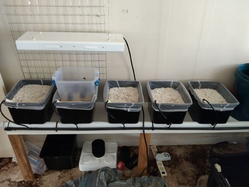

This is the bucket line..2 buckets will have cucumbers..2 buckets will have tomatoes and 1 bucket will have capsicums..

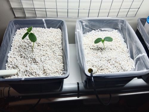

The first cucumbers..

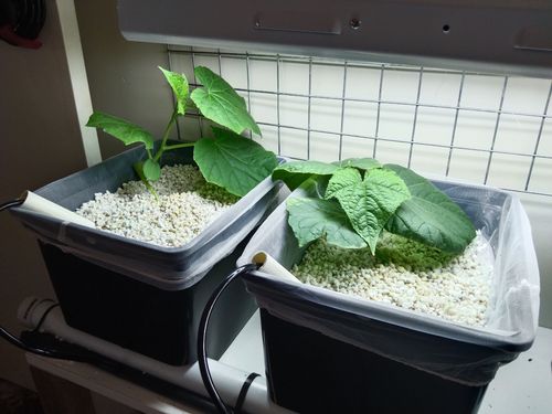

The cucumbers..

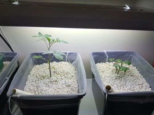

These are the tomato plants..Both seeds were germinated at the same time but the one on the right grew much slower than the one on the left for some reason..
I guess the advantage of that could be that one of the fruit crops will be later than the other thereby giving me a constant supply of tomatoes.!
