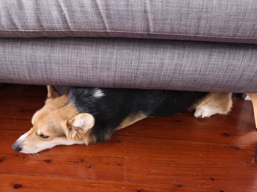

I currently have polished hardwood flooring at home, there are very big gaps in between so i'm thinking about replacing them (as things seem to keep falling through).

When I purchased the house I got it repolished and filled but I think the gaps are just to wide and I'm not exactly happy with the colour. The photo isn't that clear but the gap fits around 5 pieces of A4 paper.
Here's a photo for reference and my dog 🐶

It would be a shame to cover those beautiful hardwood floors @lina8988.

Timber-look floating laminate floor could go over your hardwood and let you go back to the original hardwood floors down the track if you wanted to - https://www.bunnings.com.au/diy-advice/flooring/laminate-and-vinyl/how-to-lay-laminate-flooring

While it's always a shame to lose hardwood floors, I understand your need @lina8988
Laminate floorboards would be the way to go. They're quite hard wearing. Stick with a matte/satin finish and you'll minimise the prominence of scratches (semi-gloss/gloss show the scratches much more easily). Also, look for an AC4 rating.
Another option is hybrid/SPC flooring. These are fully waterproof so protect against spills and "naughty pets" (but if your dog is well trained you may not need to worry about this). Hybrid/SPC flooring is great but is a) more expensive than laminate, and b) isn't as acoustically sound (no pun intended) as a nice 12mm laminate floorboard.
Do the flooring first, that way your new doors can be made/cut to size and installed once. If you did your doors first, then floors, you may need to remove doors, cut and reinstall which is wasted effort and increases risk of damaging doors.

I've gotten a few quotes, everyone seems to suggest Hybrid and do the flooring first :smile:
