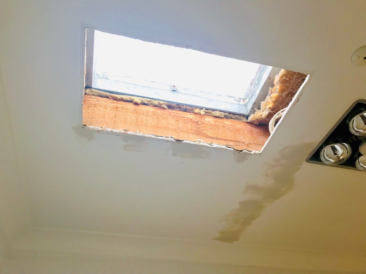

One last thing to do to finish off the bathroom project, repair and clean the skylight and ceiling plaster then paint the ceiling
The skylight surround needed replacing.The skylight surround needed replacing.

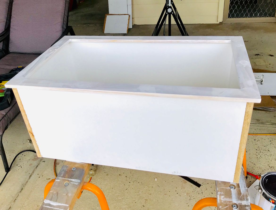

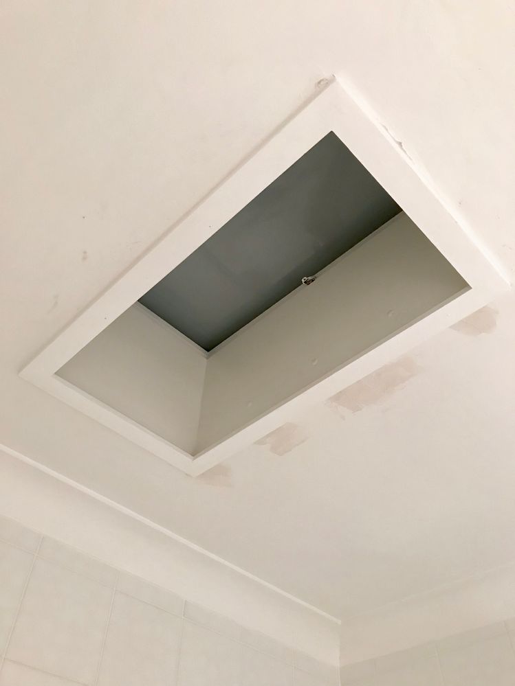

New Skylight insert built, ready for painting and instal
BrettBuilt
Re: Our Renovation Diary
All done, installed. Slight issue because the skylight opening tapers so very slightly, which meant a bit of force needed to get the box seated properly.
Lesson learned was to ensure you measure the space where it will end up, not just were it will go in
All installed. Bit of ceiling paint needed.All installed. Bit of ceiling paint needed.

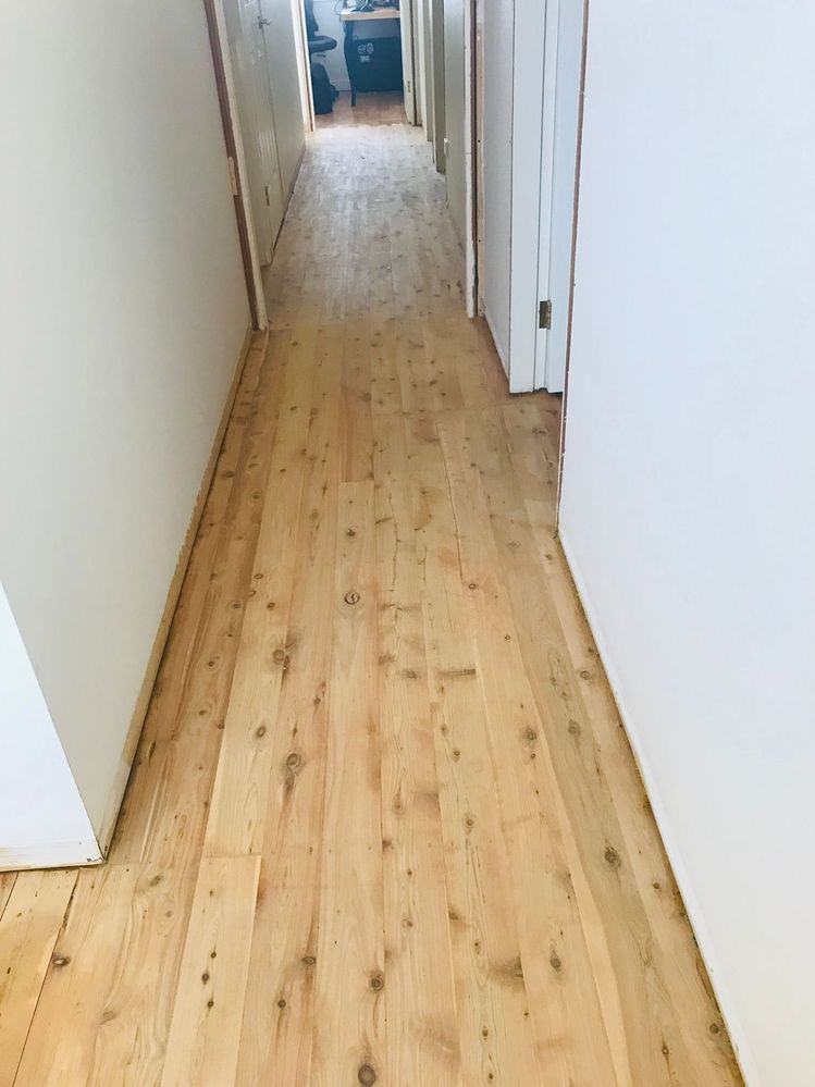

Ok a few things have progressed after completing the bathroom. I stripped the hall outside the bathroom of trims, pulled up the carpets and sanded the floor
Ready for coatingReady for coating

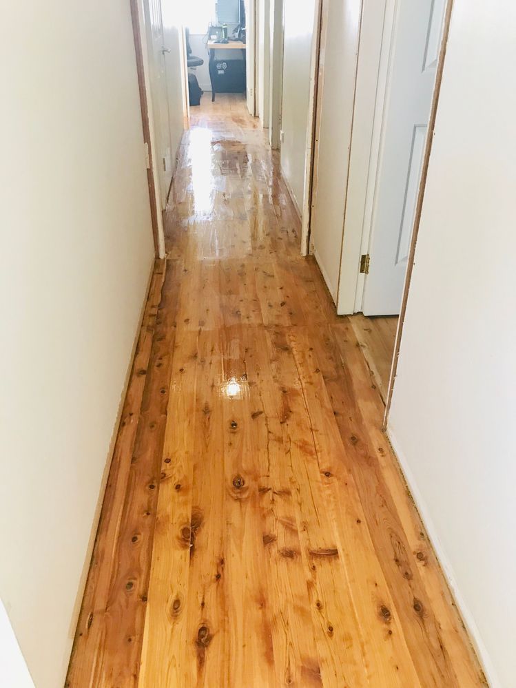

First coat of satin clear done. Need to find a 4 hour slot when everyone is out if the house to finish it.First coat of satin clear done. Need to find a 4 hour slot when everyone is out if the house to finish it.

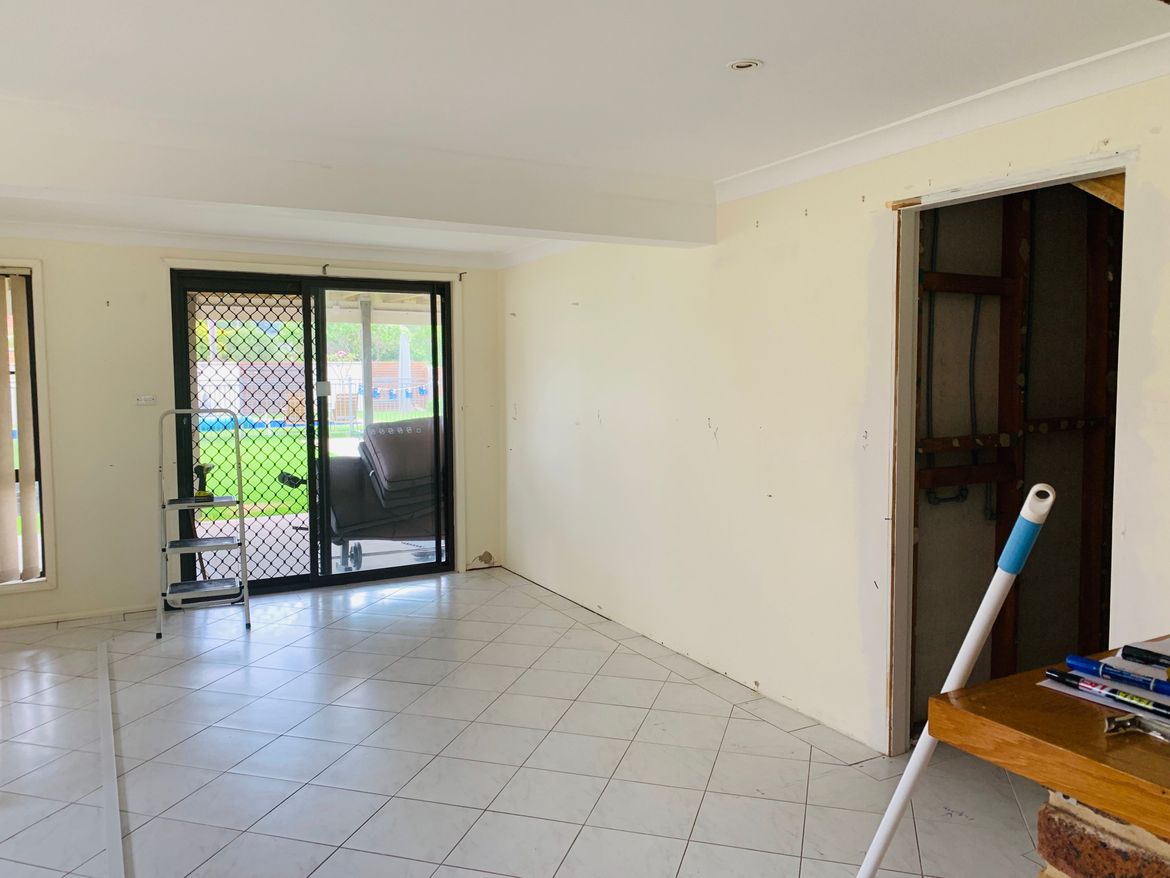

While waiting for the fam to get out of the house, I put the hall on hold and started downstairs preparing the room for the new kitchen

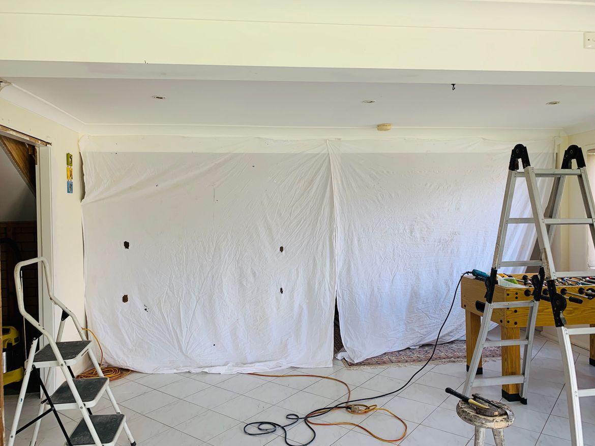

First up protect the rest of the room from dustFirst up protect the rest of the room from dust
Now to clear the room. I had already skinned the small adjoining room that will become a butlers pantryNow to clear the room. I had already skinned the small adjoining room that will become a butlers pantry

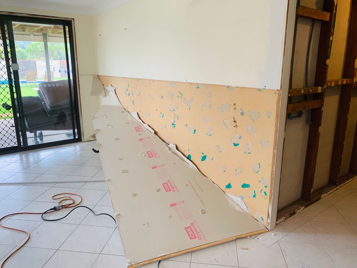

Skinning the wall to allow my sparky to run cables and run water pipes. Oh look double skin!!Skinning the wall to allow my sparky to run cables and run water pipes. Oh look double skin!!

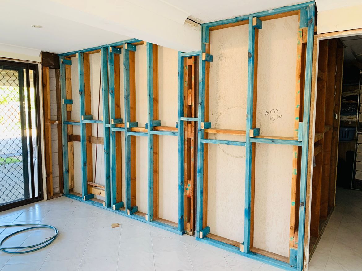

Wall skinned, but found a steel support pole. Will need to build a frame to front that wall.Wall skinned, but found a steel support pole. Will need to build a frame to front that wall.
False wall frame build and installed. Next is to remove the door and frame up for a new window.False wall frame build and installed. Next is to remove the door and frame up for a new window.
