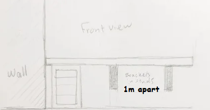

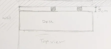

Rough sketch of idea, not to scale
Hi @Tshelf,
You have a couple of options, with your angle bracket plan being a simple and effective solution. I would, however, use a larger angle bracket such as these Carinya 600 x 300mm Black Heavy Duty Twisted Stay Brackets, so you can ensure the outside edge of the desk is well supported, as you will be resting your forearms on this outside edge while typing.
Alternatively, if you didn't want to use angle brackets and you were happy to keep the second set of drawers, you could simply add some supports to the underside of the benchtop, in a similar fashion to what I have shown in How to build a dining table using Specrite panels? Attaching timbers to the underside of the benchtop will add support that will help prevent sagging without the need for attachment to the wall.

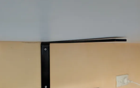

I couldn't get a good shot of the whole desk, but here's a picture showing the raised corner caused by the sag in the middle. The gap on the left is about 5mm and the desk sags a further 5mm in the middle. Since the sagging isn't too bad, I was hoping gravity and a bit of time would be enough to correct it.
Hi @Tshelf,
Using your original brackets and adding an adjustable leg should work fine, I would just make sure you use some good long screws into your studs. These Zenith 10 - 8 x 75mm Galvanised Countersunk Rib Head Timber Screws should do the trick.
To counteract the sag, it might be worth taking the top off, flipping it and putting some heavy weights in the centre for a few days to see if you can remove some of the bend.
Once the bend has been reduced you can install it as originally intended.
Hi Jacob,
I sat the desk upside down with weights and it seems to have fixed most of the sagging. When I flipped the desk back, I noticed that there was a small gap between the brackets and the desk. This shouldn't be a problem and I'm fine to screw the desk down, right? With the added leg the desk doesn't tilt forward when I lean on it and feels sturdy.
It looks like you'd be fine to secure the brackets to the top with screws now @Tshelf. Quite often, when installing brackets, you'll find a gap like that. Once you've tightened down the screws it should get rid of it.
