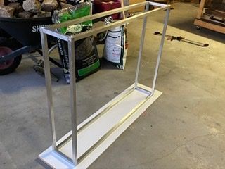

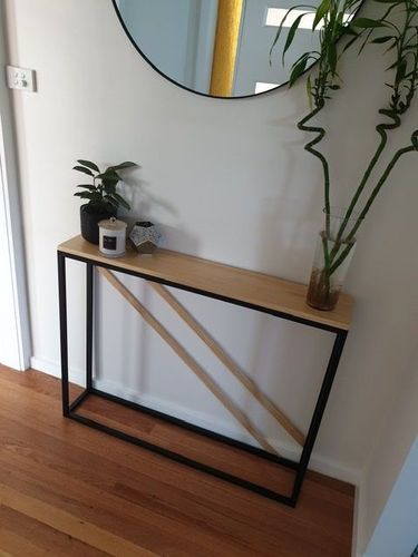

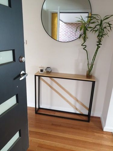

My beautiful best friend asked if I could build her a table for their new home. She found one online and asked if I could replicate it but to suit the size and style of their house. It was great trying something new (as I had never used metal for the main base). She was so thankful and absolutely loves it!

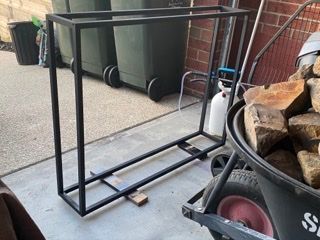

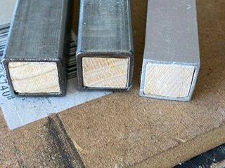

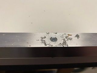

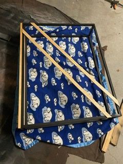

I used galvanised square metal poles, which a hollow. So to help add stability and make it easier to join I purchased timber posts and cut them down so I could insert inside the poles. Was a bit fiddly but really worked a treat!! I pre drilled the holes for the screws and made sure to countersink so that they were all flush. I used matt black spray paint. For the table top I used spec rite utility pine panel. Cut to size, sanded and stained clear. I added to lengths of pine mouldings to the rear to assist with minor movement and also add a special feature.

Love it @Tara86, very well done.
Look out for other members wanting tips about replicating your handiwork.

Perfect 🀩
Re: Timber and metal hallway table
Looks really nice :smile:  Great job
Good little trick hammering wood into the hollow metal legs - I did the same thing on my small metal mancave bar frame, and screwed the bartop straight into those bits of wood to secure it, you did the same?
I was alot "dodgier" with my bar though  - the wood inserts didnt quite fit but using a big hammer I forced it in and it automatically sliced off the excess hahahah, your work looks smick mate gotta be happy with the result :smile:
