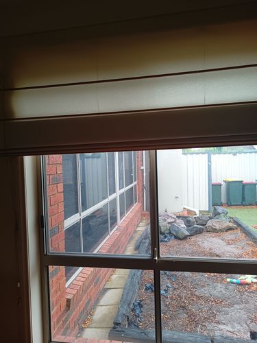

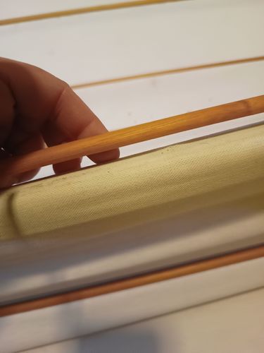

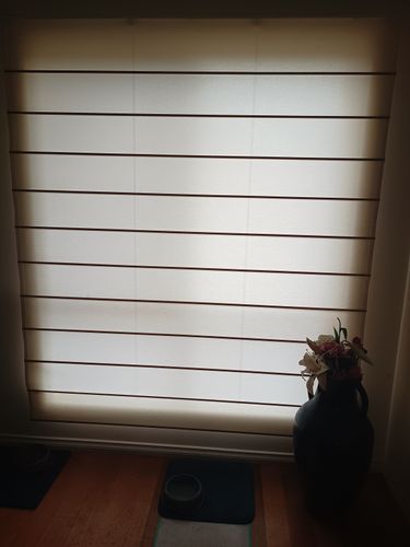

Hi everyone!! I'm hoping to get some advice please.
I have a number of Roman blinds through out my home which need some repair work. On some of the blinds the wooden dowels are becoming detached. What i thought at first would be an easy fix has turned out to be a bit more than that, and any reasearch i do is making it more confusing. So i am hoping to get some advice here.
The dowel isnt terribly heavy, but the fabric the curtains are made from is fairly thick. The dowel rods are 10mm in diameter, and are cut in half. So one half is attached to each side of the fabric, making it 13mm from one edge to the other.
I can see that staples were used when it was first made - the are so very small, and i dont have a staple gun for staples that size. I have tried larger staples with a general staple gun but they dont really work going thru the dowel. I have also tried some fabric glue (a cheap anko one from kmart) but it doesnt have much hold, and also takes a day to dry. Its also not the easiest to weigh down while it is drying as the rods on each side are curved and they roll around and shift a bit. Its a pain as there are other designs for roman blinds which would have made it a lot easier than the design of mine.
So I'm open to any suggestions and ideas please. Ideally, with the hope of keeping costs down, i was thinking maybe some sort of glue that could be used on both wood and fabric, that has a quick set/dry time where i can physically hold it together until it bonds. After that I'm happy to give it time to to fully dry before use, as long as the dowl and fabric are attached.
I have attached a couple of photos to help visualise what im saying (please excuse the ugly view out the window, we have a few projects on the go right now, as well as a beautiful 15mth old Staffy Cross who has toys scattered everywhere!)
Any guidance and help with this project is greatly appreciated.

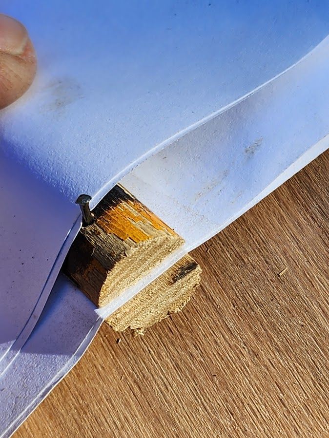

Morning @Sainterchic
"Yes, it's fabric sandwiched between two half dowels."
OK. A quick experiment outside - using paper as the fabric.
I was thinking panel pins (12mm X 1mm) and a small hammer.
Regularly spaced. Pre-hammer one side first.
Maybe this way glue is not required?
Keep us posted.
