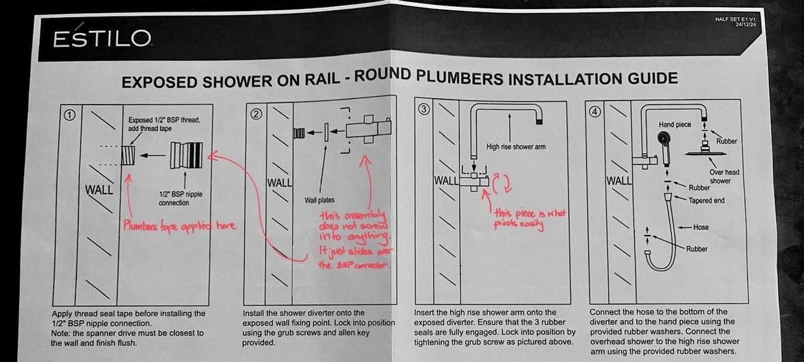

Thanks for the prompt reply, however, these instructions and the parts provided don't neccessarily all crew together, some parts just slide on, that's why I assumed the grub screws were to hold parts in place, but it seems like they are used to stop them from coming apart rather than stop them from moving.

Hello @Triston
Thank you for posting the installation instructions. Just for clarification, the 1/2-inch BSP nipple connector must be very tight on the threaded wall outlet. It must be tool tight and not just hand tight so that it will not move when something is attached to it. When the body assembly is pushed onto the nipple connector the grub screw is the only thing that will prevent it from moving. If the assembly moves it means that the nipple connector is loose.
However, if you are referring to the shower head holder there is a screw inside the holder itself that you can possibly tighten to prevent the shower head from drooping. If after tyring out these repairs and you still run into issues, I suggest bringing the assembly back to the store for a return or an exchange. Please remember to bring your docket so that they can track your purchase.
Please give these repair suggestions a try and let me know if they work.

Thanks for the suggestion, it's just that I have no tool that can tighten the round nipple connector, and no I was not worried about the shower head holder. Upon reflection, the nipple connector possibly could be tightened further and I will try this. However, overall it still does the job, just me wanting the shower head and assembly to not be able to pivot.
