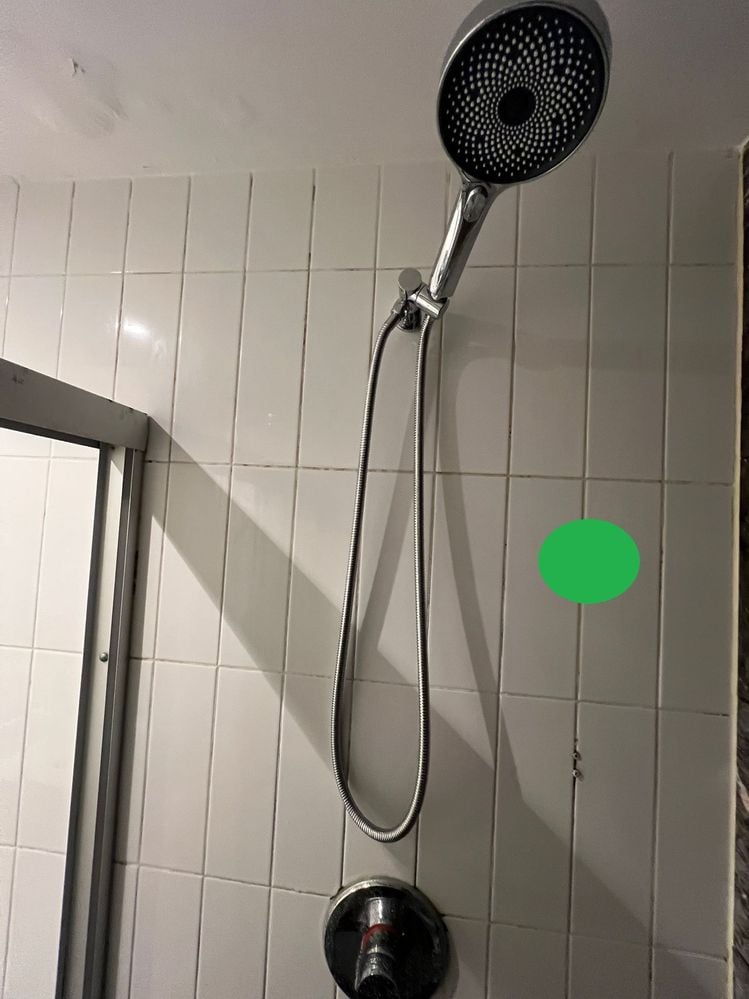

My missus isnt tall enough to grab the showerhead from the current installed height... I am wondering if there's a product I can place to hold the showerhead in place like where the green circle is. It will help her massively!!

I propose looking at the Flexispray Chrome Bermuda Shower Bracket. This is a wall mounted bracket that you can use as a secondary spot to hold the shower head. You'll need to use a QEP 6mm Diamond Tile Drill Bit in combination with Ramset 6 x 38mm Universal Anchor to hold the bracket in place.
The general steps will be to drill a hole in the tile and place the plastic anchor into the hole. Squirt some Selleys 300g Clear Wet Area Waterproof Silicone Sealant inside the plastic anchor so that it forms a seal when the screw is driven in. Put some silicone on the back of the bracket and screw it in place. Put some silicone on top of the screw head and let it cure properly before you begin using it.
