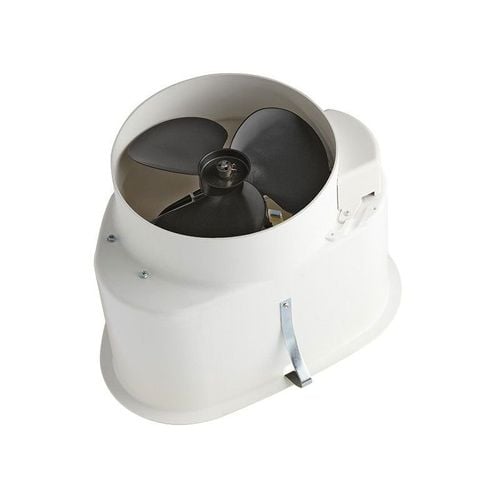

IXL Open duct one
Saw this model, but do have bad reviews
