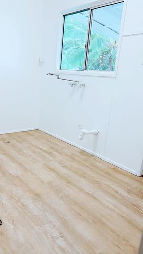

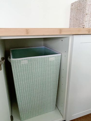

We wanted to maximise space, add storage and create a feeling of calm.

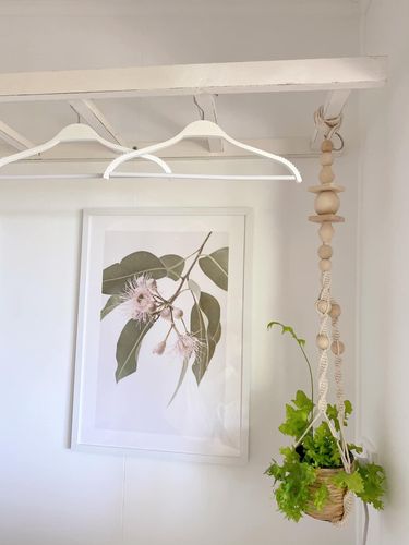

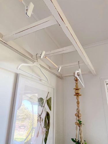

We added a kaboodle bench and bamboo bench top for storage and work surfacce. Hung timber Ladder from wall for drying and replaced tiled floor with vinyl planks.
Materials
Kaboodle cabinets
Bamboo benchtop
Dulux Aqua Paint
Dulux Lexicon 1/4 for walls
Bunnings Tapwear
Tools
Steps
Step 1

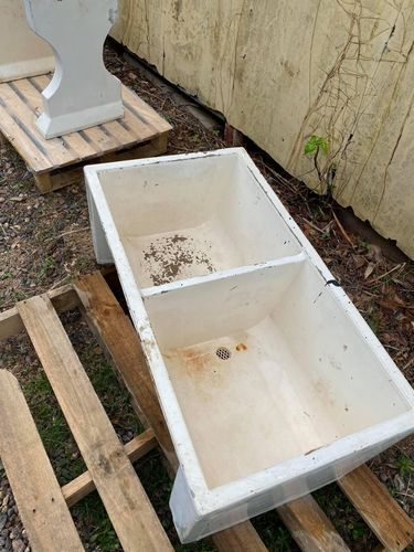

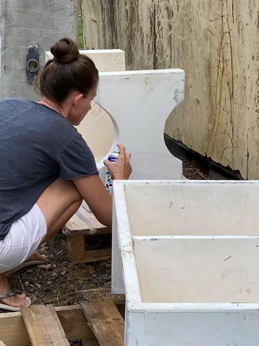

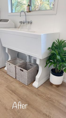

Removed old laundry tub and resurfaced a double cement tub using Dulux Aqua paint.
Step 2

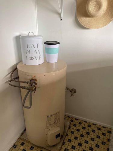

Removed hot water heater and put outside.
Step 3

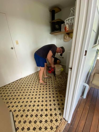

Lifted up old tiles and replaced with vinyl planks
Step 4
Added Kaboodle cabinet with Bamboo bench top. Allowed on end for laundry hamper.
Step 5
Attached a timber ladder to the wall for drying
