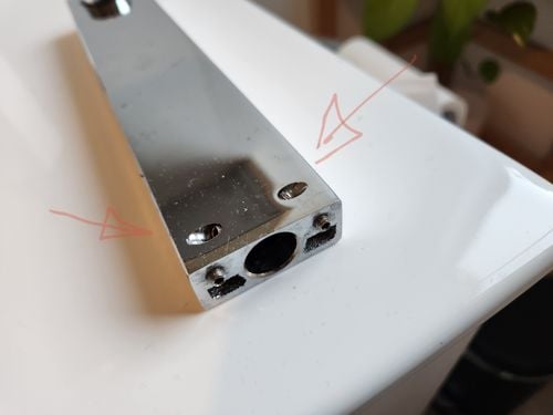

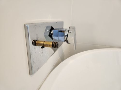

Odd issue, the spout from my bath mixing unit has come shooting off the wall spigot while filling up the bath (i.e the tap was open on full pressure).

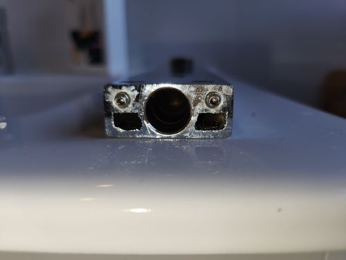

The spout only relies on 2 small grub screws tighting against the smooth, curved brass sides of the spigot. The screws do have a pointed end, but it doesnt press i to the spigot.
This same thing also happened 6 months ago, so it's not isolated, and I know the screws were tightened up as much as they could be without stripping the heads.
Is this a normal mechanism, as it seems really unsecure under a full mains pressure water line? Am I missing something on how it's attached properly? Is it busted and I should get a new unit?
Just looking for advice if it's something a I can fix myself or if I need a plumber.

I can clearly see the pointy end of the grub screw and am surprised that it is not digging into the brass surface of the wall spout. I suggest using a Gorilla 7 Piece Metric Fold Up Hex Allen Key Set to tighten the screws of the spout. The Allen key body should give you a better grip and allow you to give the grub screw a tighter fit.

I have a hex set i used to tighten it the last time it came off. I tightened it as much as i could without worrying about snapping the heads or stripping the thread out of the spout.

I think i will use some loctite to be sure, and i will try to use a hole punch or drill to make a small depression in the spigot where the grub screws tighten into to help with the lateral force

As per your suggestion - but I'd drill (very small) 'Vs' into the copper to accept the pointed grub screws, very slowly using old technology.
But before I did that - and since I don't like the spout - I'd drill and tap M5 stainless steel bolts into the sides. Trail and error will determine the perfect length. You'll get a lot more pressure/friction on the copper with bolts.

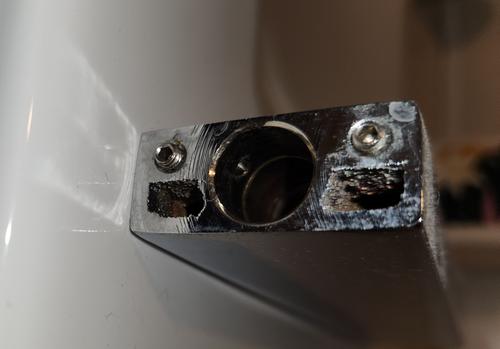

Why are there two grub screws at the back?
Do they fit into that small cavity on the wall - to maintain a horizontal attitude for the spout - then you tighten the grub screws you're having trouble with?
