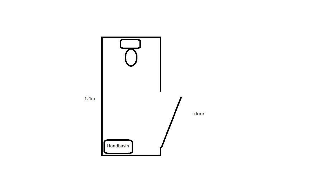

The width will be 81cm (allowing 6mm villaboard on all walls) and the length is 1.36m - my plan is to have a 2.4M high false ceiling

That is an extremelly narrow room, I would suggest to mock up the width and take a seat in the mockup area. I would include the door opening as well.
I am just trying to picture the space, are you going to have a hand basin to wash your hands in theer as well?

Yes it is a very small toilet room. My plumbers felt whilst it is small it is doable. I have attached a floor plan for the toilet room to give you understanding of the plan. Will only be a very small wall hung hand basin. Obviously toilet and hand basin not shown to scale but in planed/proposed locations 1.4m X 82cm toilet room layout with 770mm outward hinged door1.4m X 82cm toilet room layout with 770mm outward hinged door
