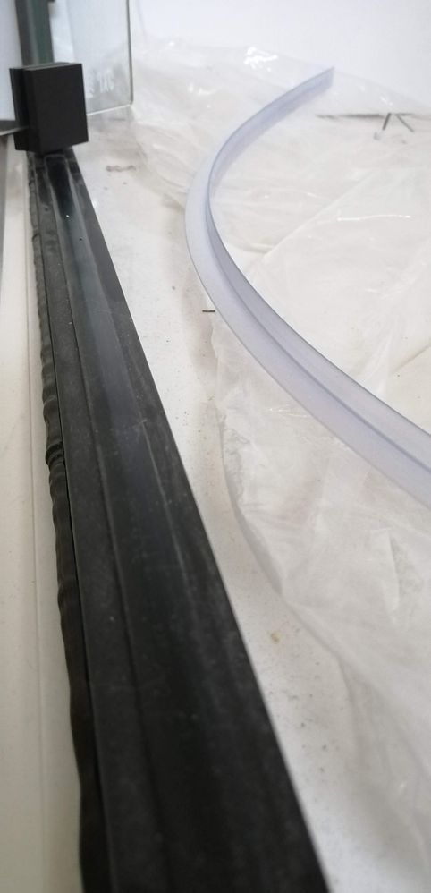

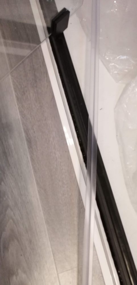

hi we bought mondella 2000 x1200 x 900mm Matte Black semi frameless shower
I need some advice
Please see attached photo. there is gap at the bottom, between shower door and bottom frame. Due to this, when we have a shower, there is water leaking outside the shower
the mondella shower did not come with any sealsIMG-9593.jpgIMG-9587.jpgIMG-9586.jpg
Any advice or tips would be helpful

First our 25 year old shower started leaking, second our plumber talked us into a whole bathroom renovation. On first use, the Mondella semi frameless shower screen leaks. Yes we couldn't find the correct seals at Bunnings but elsewhere, fitted and not fixed. It seems that the aluminium channel, that connects to the shower base, fills with water and then it dribbles out over the bathroom floor over the next 4 hours. Plumber x 3, still leaks.
SOLUTION: I plan to remove the Mondella semi frameless shower screen and dispose of it thoughtfully. I plan to purchase a shower screen somewhere other than Bunnings. It seems that Bunnings, won't be beaten on price, but the will be beaten on quality.

Welcome to the Bunnings Workshop community @Sunniva and @WetFeet.
It certainly appears from the feedback received that there's room for improvement with the design of this frameless shower screen. I've passed your feedback on to our team, and we'll have Mondella take a look at these issues to see what can be done about resolving them.
I apologise for the inconvenience, and we appreciate your feedback. If you'd like, I can have your closest store provide the required sealing strips to resolve the issue. Or, if you feel that the screen is not fit for purpose, we can discuss with your local store the options surrounding the return of the product.

Seals attached to the door, extra aluminium half dome put under door. Silicone at every joint! and it still leaks. Water coming out of the bottom door hinge! You have got to be joking! This product needs to be removed from sale.
Regards Peter M
Could I be forgiven for being quite angry about this?

I'm so sorry to hear that you're still getting a leak in the shower. There is the possibility that the water is somehow flowing onto the hinge and travelling to the post then to the outside of the shower. Would it be possible for you to post a photo of the hinge and how the shower seals sit next to them? We'll have Mondella take a look at this issue to see what can be done about resolving them.

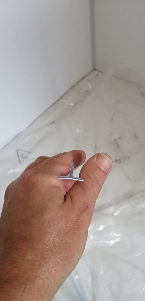

Hi all, I have the same shower on a Mondella Base. I received a T Profiled Seal with the Unit, which obviously has been added by Mondella.
No Instructions on exactly how to use that seal. I assume it will sit below the Door, but the Existing Black Centre Seal is convex , so attaching that on top of the Existing will be problematic & unsightly for sure. Do I remove the existing black push in Seal and silicon on the supplied T profile ?
I dont like that idea as mould will surely precipitate eventually, and scraping silicon off Black Frame spells trouble. (im a Handyman, so have seen issues like that first hand)
Can anyone please share their rectified solution.
Cheers & thanks in advance.

Many thanks for your patience @Greensyboy.
I apologise, as I've been in contact with the Mondella team, and it appears you've received the incorrect seal with the product. I'll reach out via PM for some details and have them send you the correct seal.

Welcome to the Bunnings Workshop community @Bill163
What seal are you using on the bottom of the door? The current seal should be one that pushes onto the bottom edge. If that's not the one you have, it can be sent to you by contacting spareparts@kineticsourcing.com.au.
