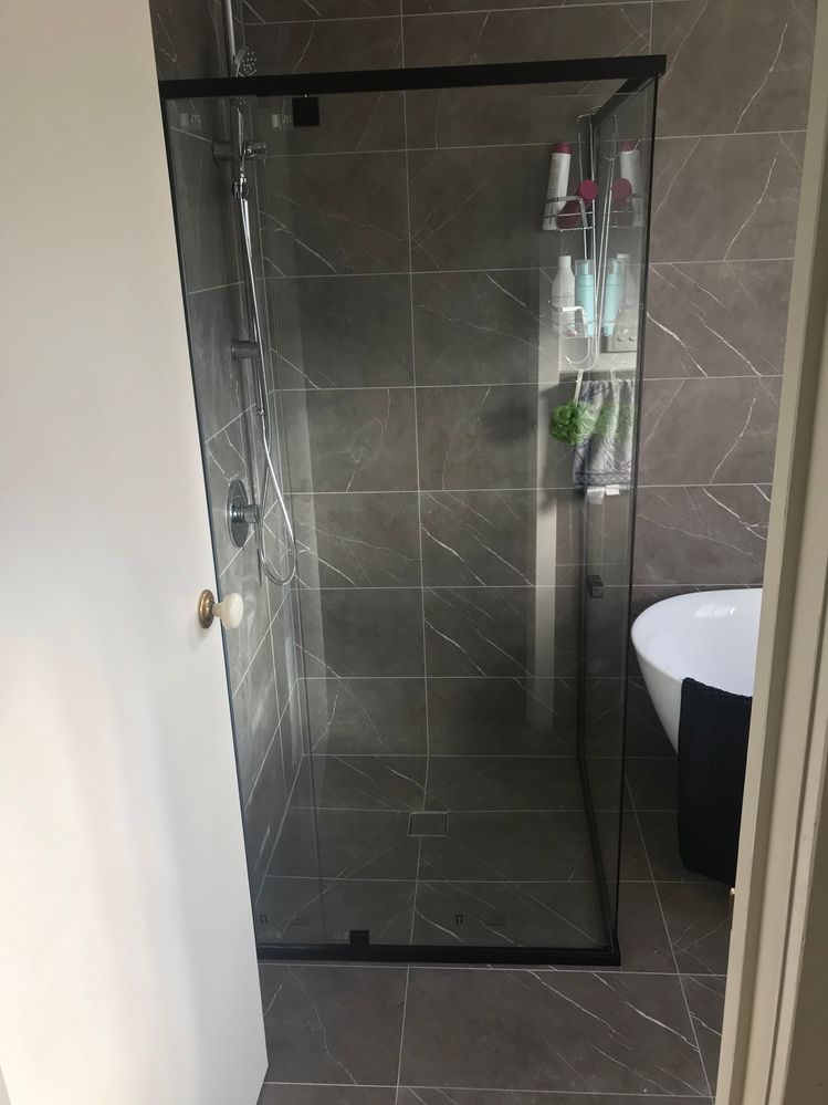

hi we bought mondella 2000 x1200 x 900mm Matte Black semi frameless shower
I need some advice

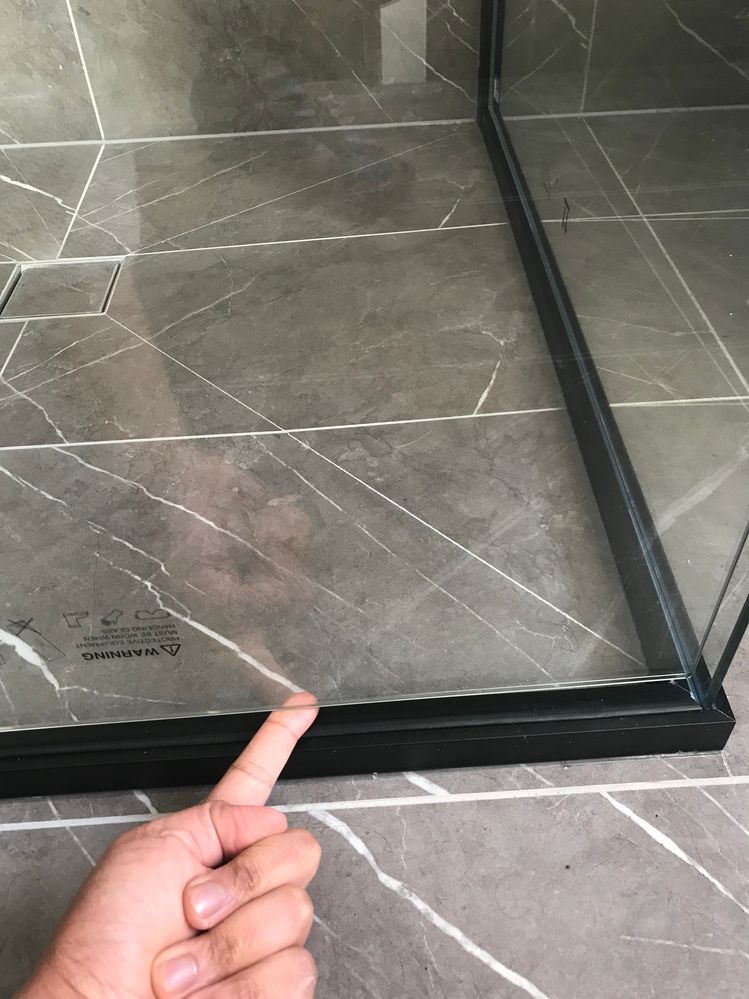

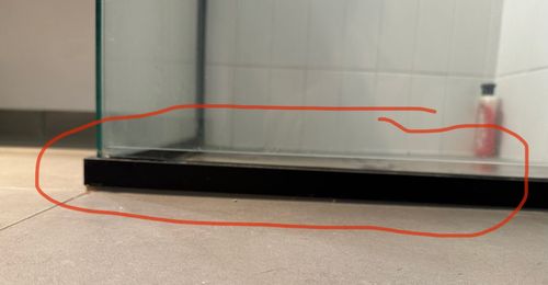

Please see attached photo. there is gap at the bottom, between shower door and bottom frame. Due to this, when we have a shower, there is water leaking outside the shower
the mondella shower did not come with any sealsIMG-9593.jpgIMG-9587.jpgIMG-9586.jpg
Any advice or tips would be helpful

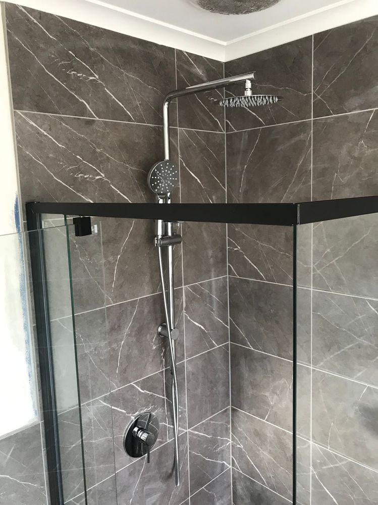

Dito...  recently installed a Mondella frameless shower screen from Bunnings (Rocklea Brisbane) and have the exact same issue with water leaking everywhere because no door seals were provided.

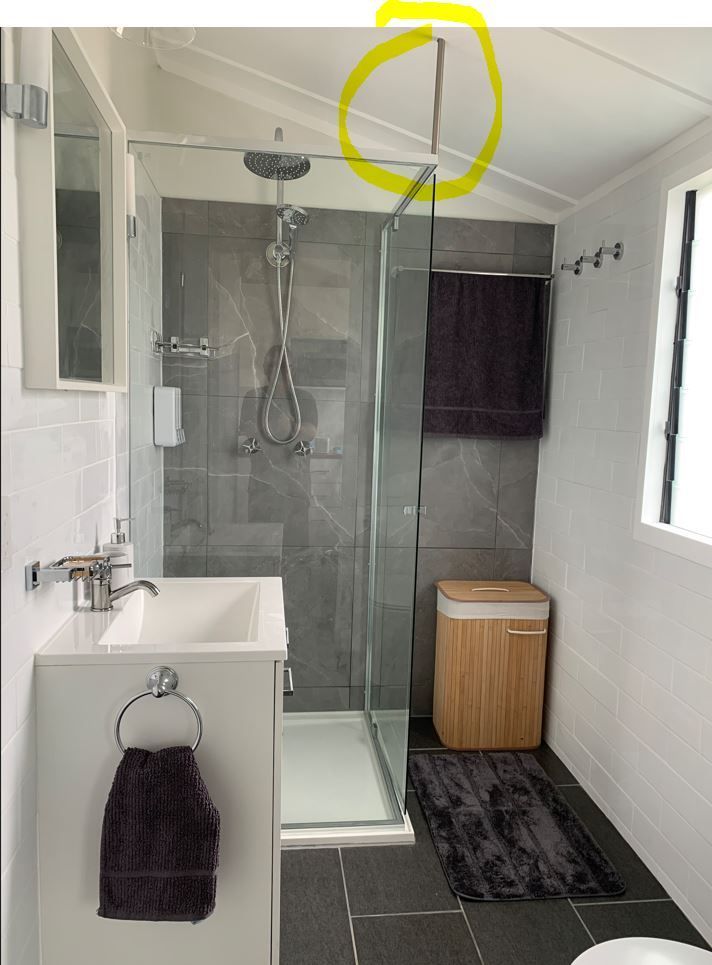

Secondly and what really really concerns me is that the top of the frame doesn't seem to lock into the glass at the corner of the door opening. A slight bump on the frame pushes up which in turn allows the entire door itself to pop out of its top pivot hinge point and fall... It is completely unsafe and I won't allow my children to use it.
I understand this is a budget unit but surely it must still be able to stop the water from entering the wider bathroom area and be safe to not to worry if the glass door is going to collapse on someone at any point.

I'm sorry to hear that you've been having issues with your shower set. In regards to the loose aluminium frame, I propose double checking the installation screws as it's possible that a locking screw might have been missed in the assembly process. Technically the frame should be secure and not allow the frame or door to come apart when bumped.
In regards to the shower seals I recommend contacting spareparts@kineticsourcing.com.au direct and request for a set of seals. I also suggest contacting Mondella on the same email and informing them about the top of the frame where it doesn't seem to lock into the glass at the corner of the door opening.

Hi @EricL thanks for the quick reply. For the seals, I did speak to Harry from Kinetic and he advised: "We did supply these seals free of charger however, i was informed just yesterday that no courier company will collect these seals anymore due to the extreme length of the seals, the couriers are being charged excessive fees for parcels over 1.8 meters in length resulting in them refusing to collect the seals.
I'm happy to pick up the seals from any Bunnings Brisban location. Can you please advise on this!
Secondly, with the framing issue, I suspect this is a design fault with these units as I don't see any way to stop the top rail from lifting. Anyways I made my own custom fix with a shower curtain rail to secure the top rail from lifting. Photo attached, but if you have a better solution I'd love to hear about it.

Hello @cspencer
Thanks for sharing that photo of your shower. I'll give Kinetic a call tomorrow and find out what can be done about the seals.
In regards to your shower frame, I'll forward that photo to Kinetic as well so that they can see what's happening. I'll get back to you as soon as I have more information.

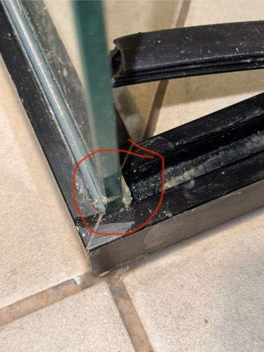

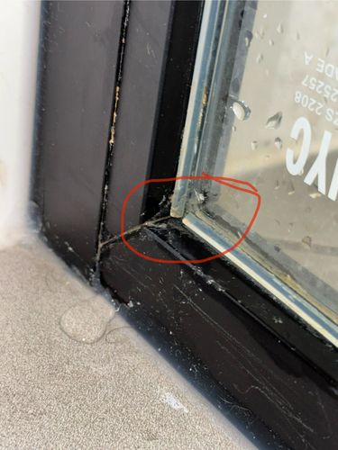

The other issue is as others have described with the aluminium frame , it fills with water which then seaps water outside of the shower for hours after using it. This happens in each of the three corners of the shower. Was there a fix for this? The issue is definitely not the the silicone between the frame and tiles - it is where the glass pushes into the seal and then into the frame.

For warranty issues or to enquire about the supply of seals for Mondella semi-frameless shower screens it would be best to contact them directly at spareparts@kineticsourcing.com.au. Please send any images you have illustrating the issue through to them and specify any troubleshooting you've already attempted. If you have a proof of purchase, include that too.
I am unaware of any particular fix for leaking water out of the corners of the frame. If water appears to be entering the channels that the glass sits in on the frame, then adding silicone sealant between the glass and the frame could prevent water entry.
