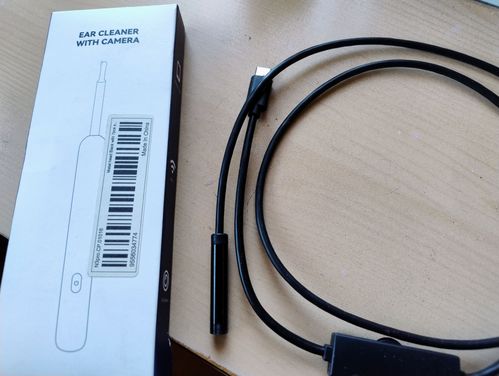

What do you have in your bottom kitchen drawer?
Although our bottom drawer was overflowing I still managed to squeeze those two items in there.
Wi-Fi Ear Cleaner and Wi-Fi Endoscope Camera.
Recently use the endoscope camera to track down ants under the gas cooktop.
Also useful for peering into little holes.
