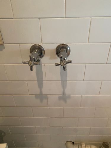

A few months back a plumber fixed a leaking pipe and I asked him to stop the laundry tap from dripping. His young apprentice did this - but its now leaking more.     I would like to take off the handle and see if it needs some more plumbers tape - but I'm not sure how to take off the handle - it doesn't seem to pull off - what to do?

I've placed some images below to give you a better idea of how the handle pieces go together. In the meantime, don't make the handle assembly any tighter. Can you please remove the round brass threaded locking nut as well as the brass horseshoe. These parts need to go on the spindle first before you screw them on the handle. Please have a look at the sketch and let me know if you have any questions.

Thanks Eric!!   Those diagrams were very helpful as they showed the exact placement of the individual parts.     I have successfully fixed the leaky taps.  Couldnt have done it without your help.  Thanks!!!!!
