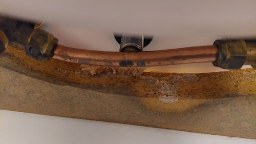

I've just discovered that the copper pipe under my bathroom basin is leaking on the left where it connects with the hot tap. Will I need a plumber to fix that or can I DIY (and if so, how?) and how do I remove and replace the particle board cabinet shelf which has been warped by the leak and started developing mould?

Thanks for your response. The pipe is leaking from the black connector to the right of the silver pipe (where the copper pipe connects with the silver pipe). The hole in the shelf seems pretty snug but I've attached a picture for you to look at to let me know your thoughts. Would you know how to remove the shelf? Ie would it need to be cut out?
Re: How to replace bathroom cabinet shelf?
Hi @SunnyZim87,
It looks like the plumber used a SharkBite copper coupling, which has failed. You'd need to identify the diameter and type of fitting for us to identify a replacement. Is it possible to get any photos showing it from another angle? Also, what is the diameter of the copper pipe?
If you were just looking to just remove the shelf, then yes, you could cut it out. You would just need to be very careful when approaching the pipe to ensure you don't accidentally cut it along with the shelf. A reciprocating saw would likely be the best tool for this job, but you could do it with a hand saw like this Trojan Laminate Saw. If you cut 95% of the way through, then you should be able to snap the last little bit so your saw doesn't hit the pipe.

Hi Jacob, Here is another picture of the pipe. It's difficult to measure so I measured one of the more accessible copper pipes which look about the same size and the circumference was around 4.5cm. The shelf doesn't seem to have any brackets or supports or visible screws so I'm not quite sure how it's attached and how to therefore go about detaching it?

Unfortunately, from this angle, it does not appear to be a Sharkbite fitting. You are going to need a plumber to assist with this one.
The shelf is likely screwed in place from the outside of the cabinet shell. You will either need to move the cabinet to access the screws on the outside or cut out the shelf, then use an Angle Grinder to cut off the screws.
You can then install brackets or shelf supports so the replacement shelf is in line with the old one.
You will however need a plumber to assist with the leak and reinstalling the trap. Unfortunately, due to the complexity of these tasks, they are not going to be achievable D.I.Y. and you risk causing further issues from leaks.
