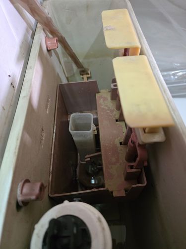

I dont know the names of the parts but I believe the 'little wings' you mentioned is the plastic flap which closes inwards whenever I press the flushing buttons (as shown in yellow arrow)?  This flag is joined to the whole flushing mechanism and I still need to find a way to take out the whole piece (red arrow).  I suspect this whole piece is secured via the wing nuts (external) which I unscrew will be able to take this whole piece out?image.png
I can see the leak into the toilet by looking down the square part and I need to find a way to remove the whole thing to change the seal/washer underneath it (green arrow).

If you are replacing the sealing O ring under the flushing mechanism, I recommend engaging the services of a professional plumber as this will require the disassembly of the entire cistern (which technically counts as plumbing work). My suggestion only involved the seating washer which is the Kinetic Seating Washers - 2 Pack. The larger internal O rings is a bit more involved. If you are only removing the flushing arm, then it may be possible to take it apart without removing the entire flushing mechanism assembly.
