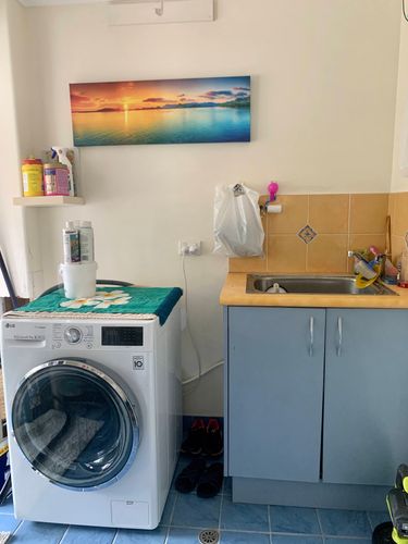

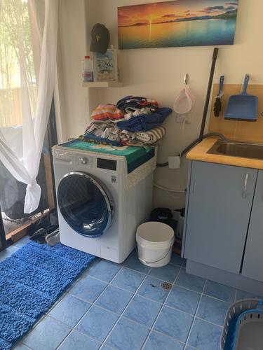

This laundry lacked functionality- it had no bench space, no cupboards. Just a small 2 door cupboard under sink.

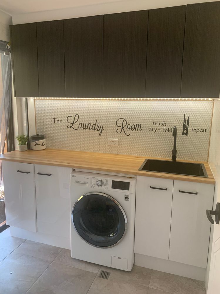

We decided to go for an industrial style laundry with some much needed bench space and more storage.
We kept plumbing to same position, to keep costs down but added overhead and under bench cupboards. All Kaboodle products and hardware.
We included pull out draw for dirty baskets to slide out next to washing machine.
this top loader is multi function and is washer/dryer combo. Added some Bunnings penny tiles for splash back!
Kaboodle cupboards and base units/overheads. Darker doors (top cupboards) special order!

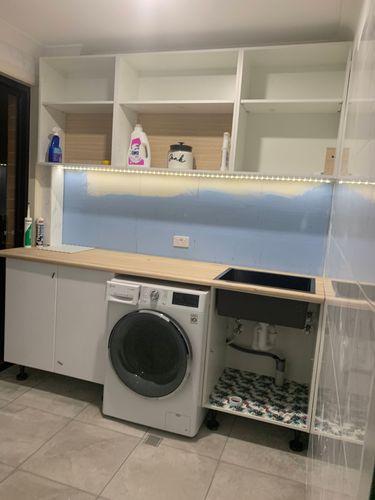

Removed old laundry cabinetry and started demo of old tiles. We took off villa board on walls and replaced with new.
then we water proofed room, and measured out Kaboodle cabinetry.
Then waterproofed entire room, before installing new tiles
We then had plumbing hooked up and finished cupboard install. Then grouted tiles, including splash back.

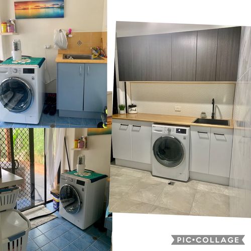

Here is before and after
Final result
